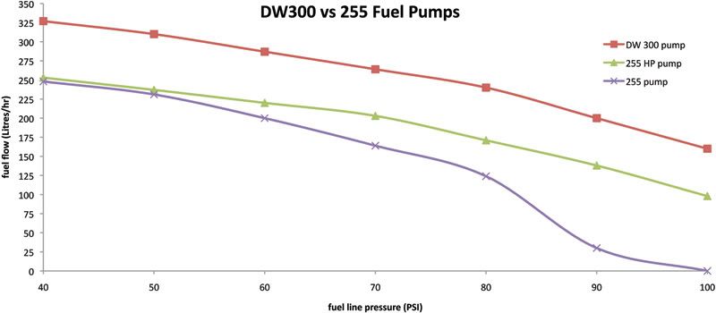

Got in touch with Deatschwerks and they gave me the following charts.
The pump has a 100PSI relief (Great for E85 adn ID1000's), 3 Year Warrenty, same fitment as the GSS342 (HP Universal 255LPH Walbro we use), turbine wheel which is quieter than the GSS342 and is going to be retailing for $170.

what do you think attainable whp will be with that pump and id1000s on e85? 600?

Hmm maybe I'll go this route and keep my KB BAP. Are there any FPR that can raise pressure close to 100psi and still work with stock fuel system. I know the fuel lab and aeromotive can but they can not be mounted on the rail. How high can the AEM FPR go?

I have emailed them about also using their pump with a BAP. Will let you know what they say.

Thanks Daryl. I can not imagine it being a problem, you can always turn the BAP down a little. I have mine around 16v right now, not set at maximum. I wonder how this would do with BAP and ID2000s. I want 650whp. If it is doable I will most likely go this route.

I don't think it will be an issue either and certainly a lot cheaper than a full blown setup. Or you could use these two pumps on the full blown hanger and have more than enough fuel for those ID2000 injectors.
I think I will try this first Martin with the ID 1000's. 500whp will be plenty for me. If you want 650whp then full blown and ID 2000 are your best bet.
