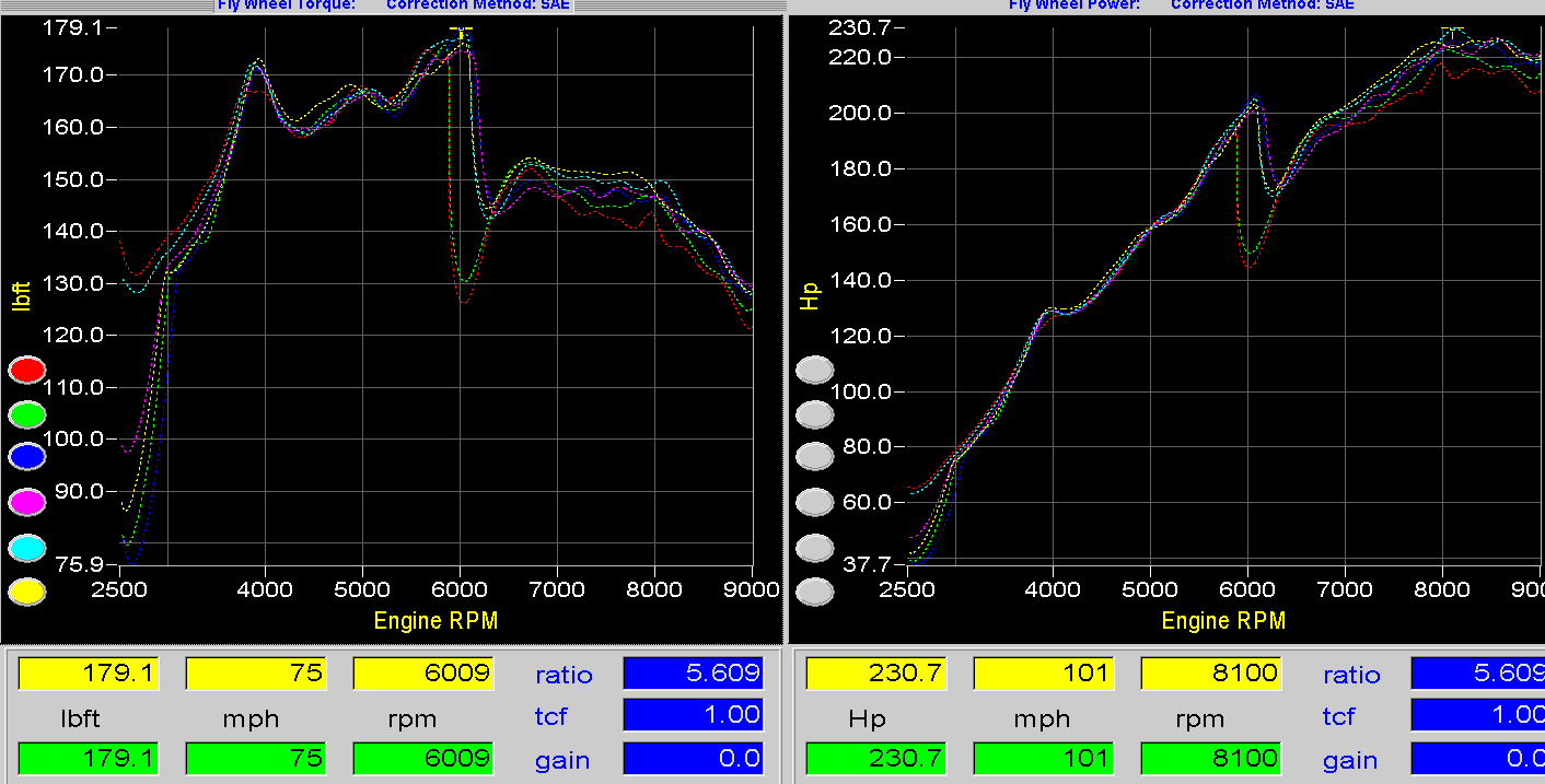

doesn't beat my awful 230whp dyno when i switched to a pfab log manifold. i was previously at 280whp then my greddy manifold cracked. AEM V1, dual 70mm exhaust, and everything else was stock greddy parts. I think i was at 8psi for both the 280whp/230whp.

I especially like how when vtec kicks in you lose 30-50trq/whp. Going for a unique set up

[left]Reverse vtec!
Holy crap! Is this not something we can complain to pfab about? If this is a design flaw it's absolutely ridiculous, we are almost competing with stock s2000's while running 8psi! LOL
Originally Posted by guamie
[left]Reverse vtec!
LMAO!
