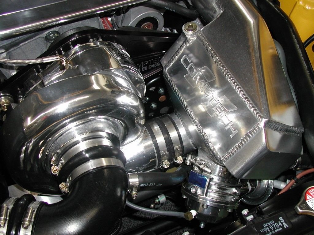

Not the exactly pict you need but you can figure it out. The smaller piece laying flat on the bench with the 4 screws and the clamp screws directly to the a/c after you remove the piece that normally would take the hose directly to CT's bypass valve. It's square under there though you can't see it.
This piece at the bottom obviously comes off.
Installed. If you zoom in, you can see how it just bolts up to the original holes.
All this (and more) came with the BOV when purchased new. Unless you get half a BOV, you should be fine.
