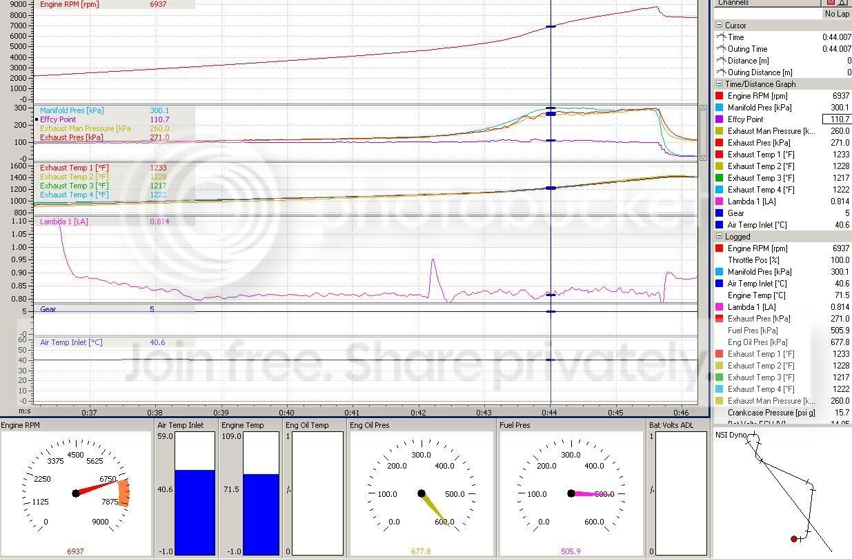

I'm not trying to hate, I think it's a great car and I'm sure your tuner knows what he's doing. The setup looks super clean. The numbers however are wrong, maybe he doesn't know it but they are. It's not even in the realm of possibility. I have as you brought up seen some of Mase's numbers that were higher than most likely possible as well and many that are about as expected I think that's a result of him tuning on so many different dyno's (how could he know what corrections are built into other peoples dyno's).
Joe, your example of how a 35r can make the big power comes from a dyno jet on STD correction which is not the standard and happens to be the highest of all the correction factors.
Do you really think there are "freak" fuel pumps that happen to flow almost 200 more horsepower on the same car? That's pretty much what your claiming since like you I see about 550 before issues on a dyno jet with a single walbro. The OP is claiming 650 on a dyno dynamics (720+) on a dynojet surely you don't believe this is possible with either the walbro or the 35R?

How could a car with a 4088R 1.19 housing, equal length tubular manifold, custom, intake manifold, no filter, 4 inch exhaust, no ac, and running on alcohol run the same boost pressure and make less power than a car with a 35R and a street setup on a dyno that reads about 12% lower.
You can say it's all in the tune but what are the chances that I have $10,000 in engine management computers, and $3000 in sensors and don't know how to use them at least up to par with the capability of an AEM. My car has over 50 hours of dyno time and every cylinder is tuned as it's own engine.

at what point in the exh system are you monitoring ex pressure, next to the 02?

Actually the "exhaust manifold press" and "exhaust press" are both measured at the turbine inlet. It's a twin scroll so I have one sensor in each scroll. The only reason the channel is labeled exhaust pres is that I use that channel in 3 different components on the can bus and if I rename it it adds a lot of complexity for no reason.
I have had one in the downpipe just to make sure I don't have excessive pressure but from a tuning and reliability stand point a sensor there is useless unless you are under water or someone stuffs a grapefruit in your muffler it really doesn't change all that much.
