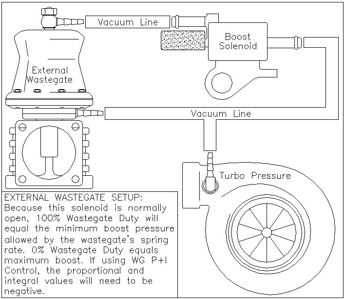

AusS2000,Apr 15 2008, 09:38 PM
Nice diagram!
