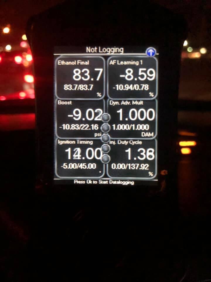

Such a cop out that he didn't blow up the car and left the fueling safe? Was he tuning for a number or making a good tune with what he was presented? He may have very well had his reasons... That's not to say I haven't seen tuners recommend injectors when the fuel system needs upgraded, but there may be more going through that tuner's mind than what you realize, considering we sometimes have cars that have mechanical issues we find on the dyno and if we had not taken the time to test, they would have blown up. In many of those cases it likely wouldn't have actually been the tuners fault... That doesn't mean we won't take the blame. Back to fueling recommendations, I regularly see the Subaru community recommend injectors because they're showing 90% IDC, however, in the calculation used, 100% isn't static and I've run them as high as 137%. I did tell the customer that he should probably upgrade his injectors at some point, but he knew what to pay attention to.
