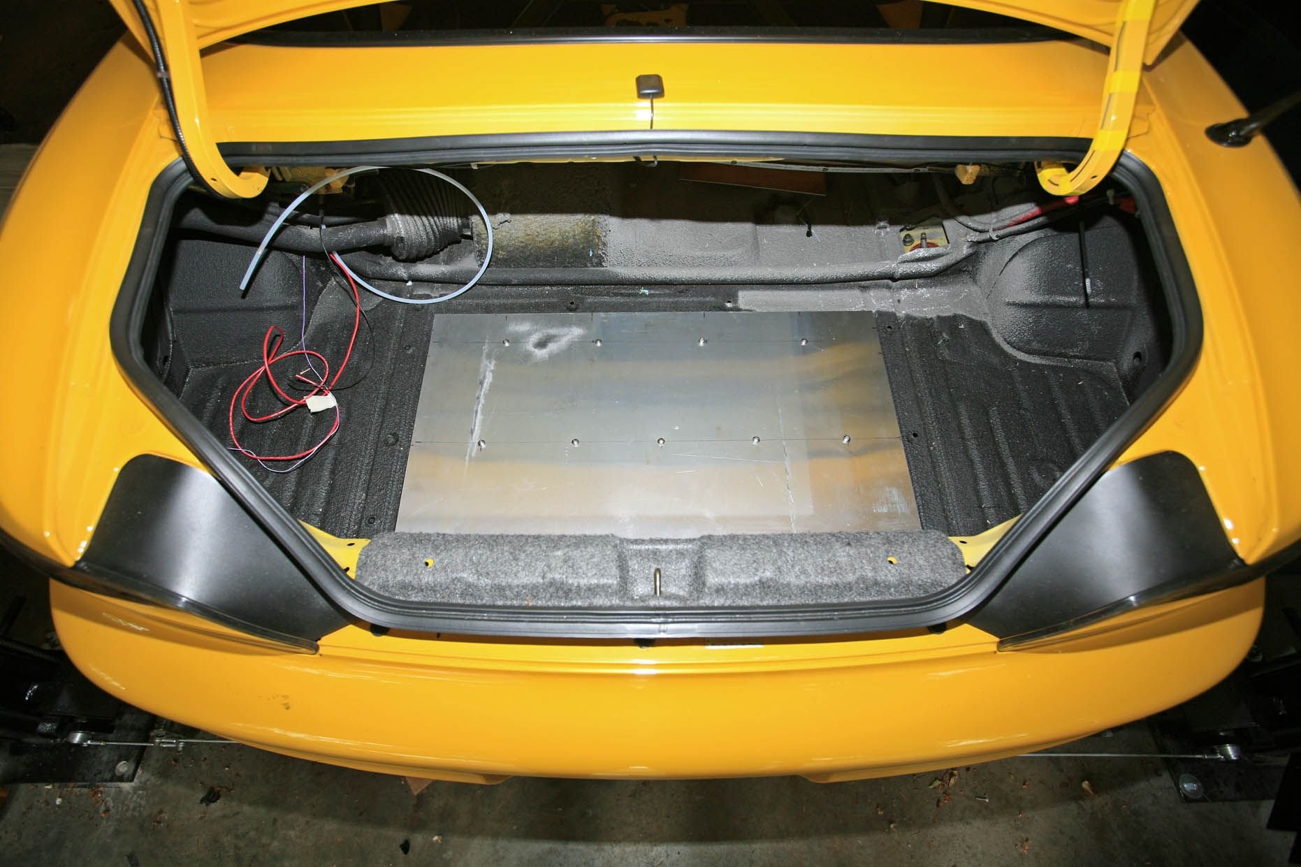

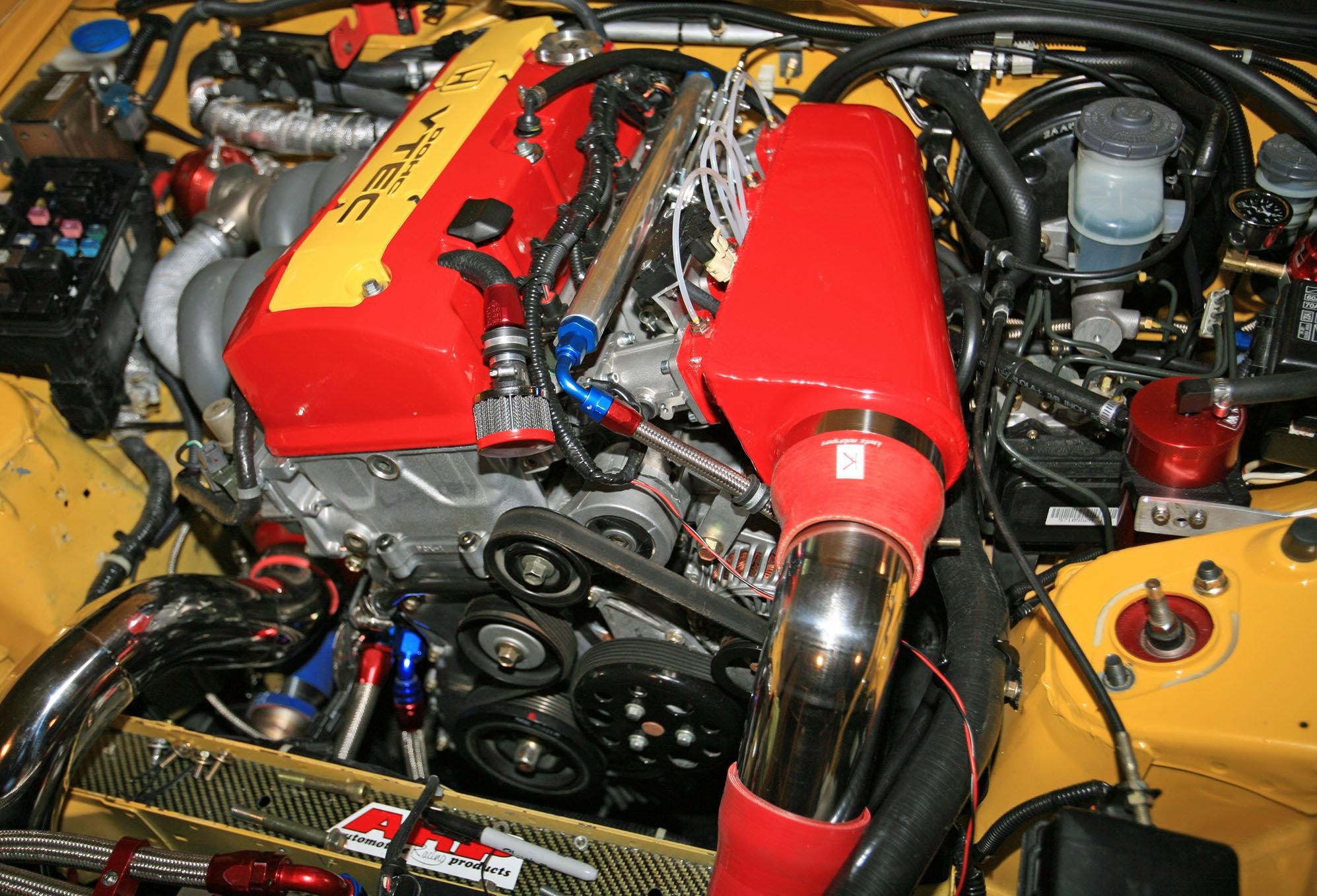

Its been a while since I posted, so I thought I would give an update. Progress has been slow, but I'm getting close to pushing the start button. I've only run into one hick-up so far; I forgot to spec a bung on the intake for the IAT sensor. So I've ordered an AEM sensor snd will mount it in the charge piping right after the intercooler. This is a better location anyway, because it will not get heat soaked by the engine. Other than that, the engine is ready for its first start and tuning. I still have to put together the water/meth injection system, but that will go fast. Today I finally located a nice spot for the pump. Here are some more pictures:
This is what the engine looks like now. As soon as I get the IAT in I'll get the clamps on.
My secret compartment for the battery and water/meth pump:
