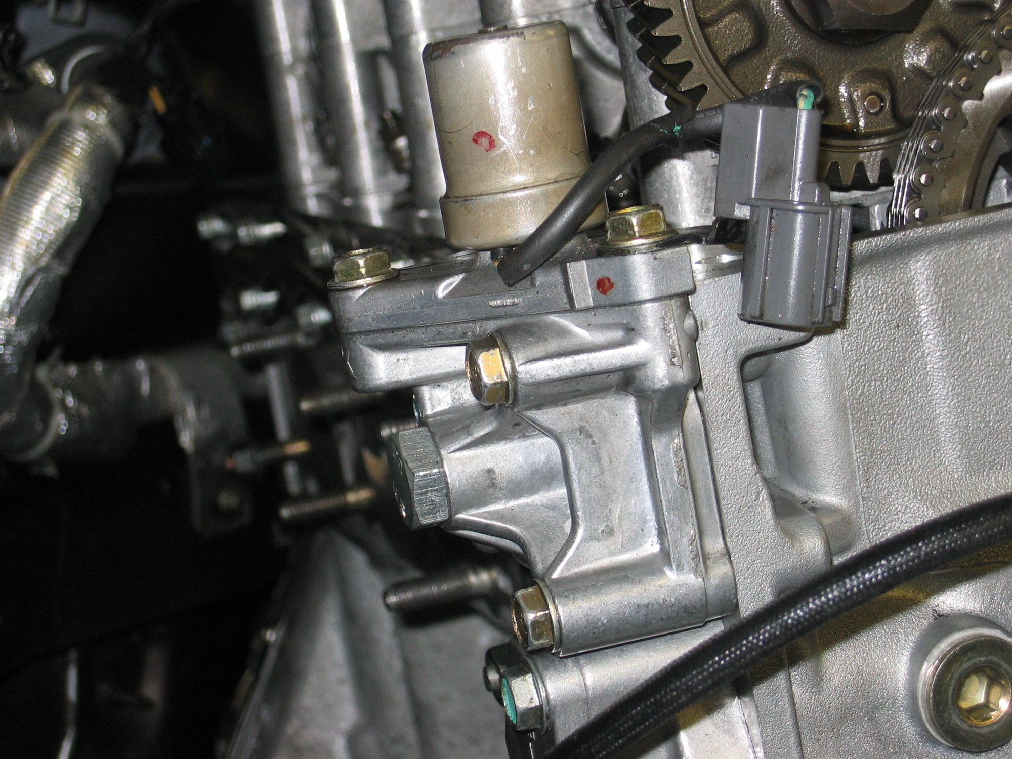

Blocked off the vtec oil pressure sensor with a bolt and some teflon and moved the wire around. I wrapped the whole unit around with some aluminumized heat shield tape with adhesive backing.
As a matter of fact I lined most of the engine bay with this stuff and it worked very well:
https://www.pegasusautoracing.com/ProductSe...sp?Product=1828

Do you have any pics of your engine compartment with the adhesive heat wrap and call me stupid but why did you block off the vtec oil pressure sensor?
wtbs2k how did you bolt your heat shield up and kenyellows2k hold did you bolt up your manifold HS?
Look in the background at the heater hose to the left. It's wrapped around with the stuff.
I blocked it off because the AEM EMS doesn't use it anymore. It would have just been one more thing to get melted since the manifold is routed right by there. You need to cut the bolt very short (same length as the sensor was when removed).
