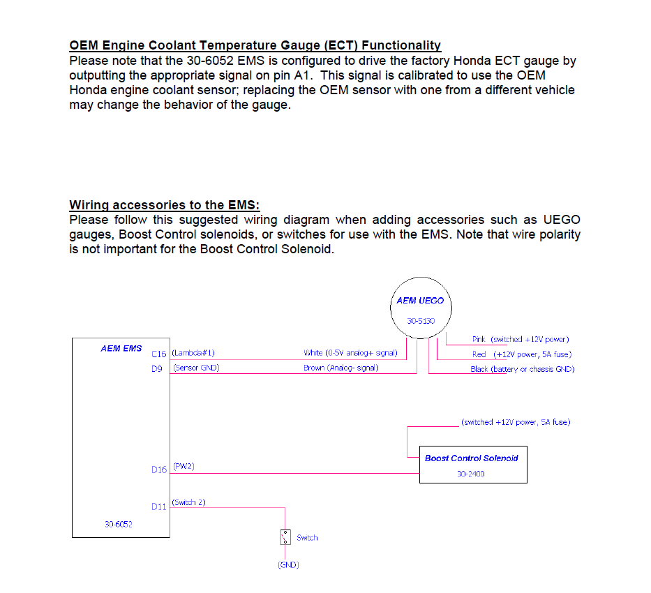

Hi,
I've searched s2ki forums for this question and found some different answers... So for once and for all:
The mac boost solenoid comes with 2 wires, I know the polarity doesn't matter.
option 1
1 wire to 12v +
1 wire to ecu
option 2
1 wire to ecu
1 wire to ground
Does the ecu PWM pin power the solenoid (option 2), or interrupt the ground (option 1)?
On the aem v2, the pwm pin is D16 by the way
Thanks

Does anyone know if this works the same for AEM v2?
The EMS powers the solenoid via pin d16, and the other wire goes to ground?

ECU powers the solenoid, other wire is a ground.

Sooooo we have two complete opposite answers....
Think imma go with the copy/paste from aem. (why didn't I find this myself, I know right. )
