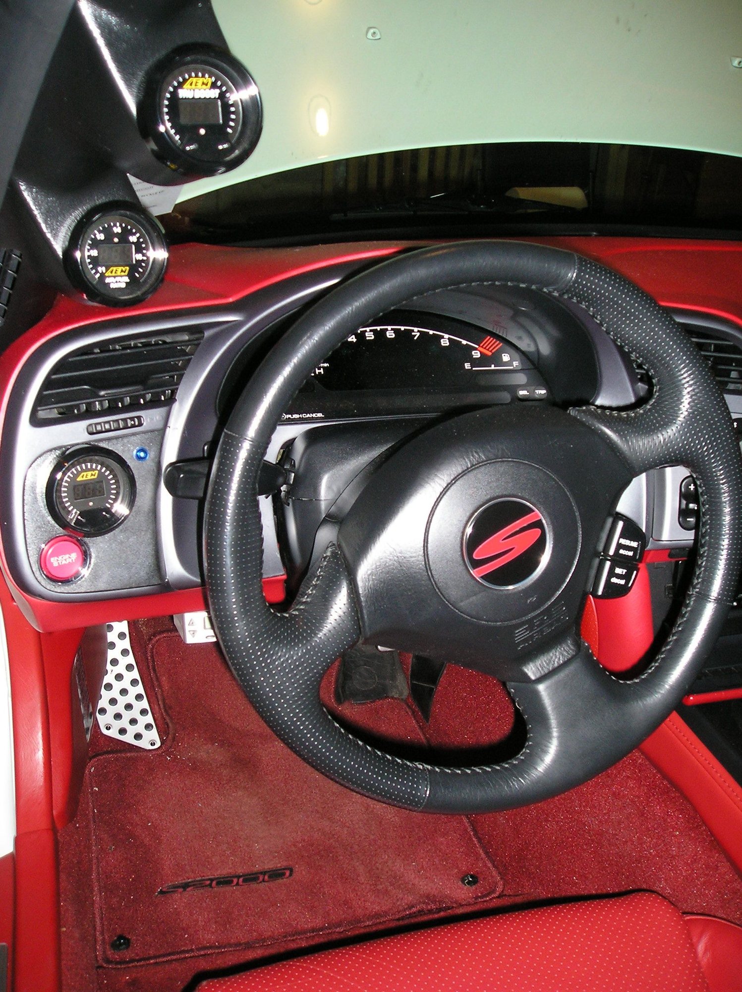

If you mess around with the progauge software you can change these to whatever you want.
Heres a pic of where mine is mounted.

Nice! I have my serial gauge on top of my steering colum because my rollcage won't allow me to mount anywhere else.
