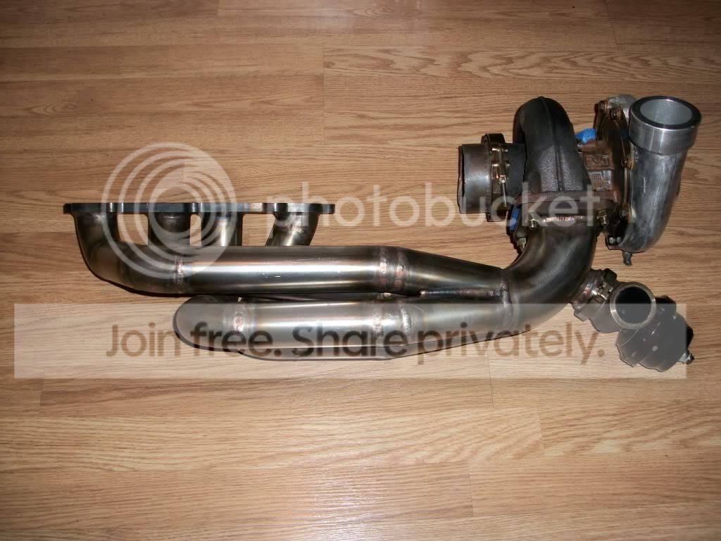

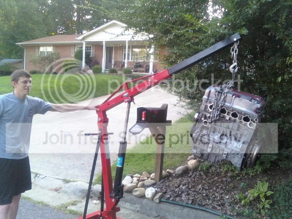

Ok so for nearly the past year and a half Ive been putting this thing together and it has gone through 3 setups overall. The motor was yanked outa the car in front of my house with no lift and will definitely go back in the car by other means. A lot of things arent pictured but I tried to get most of everything that has any significance or isnt piled up downstairs. At this point the car is looking like it will be finished before I am through with school. The car WILL be daily driven (not 7 days a week). The dd tune will be on ~18-20 and high boost will be set at 35psi on E85 . Many thanks go to my tuner as well as the several friends that have lent a hand in tearing this thing apart. Much gratitude to the friends and members that have supplied many of these parts . The cars setup consists of the following:

Turbo

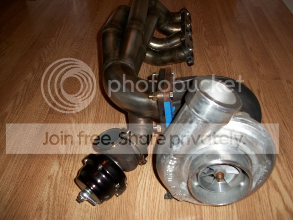

1-off Sidewinder turbo manifold

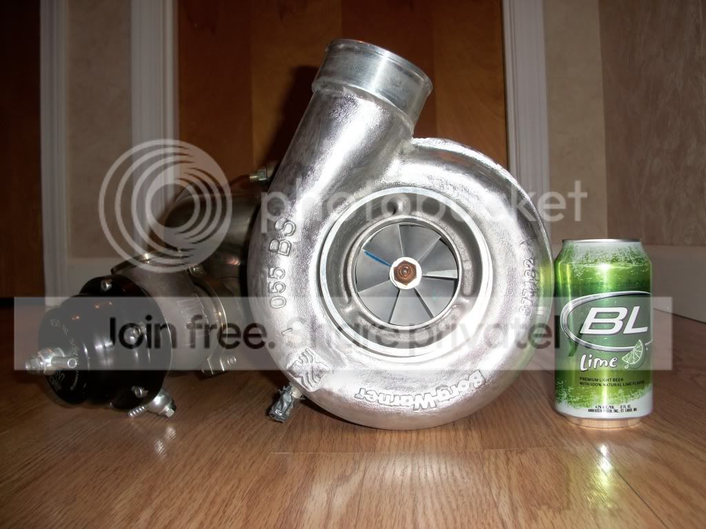

Borg Warner 76mm Turbo 88a/r hotside
4 inch turbo-back exhaust

Tial 44mm wastegate

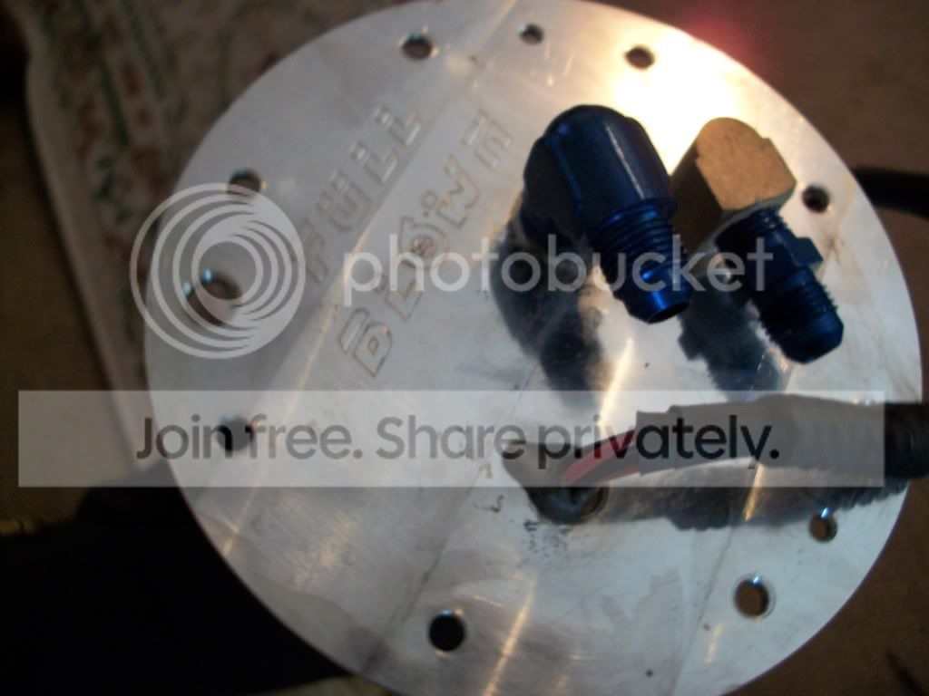

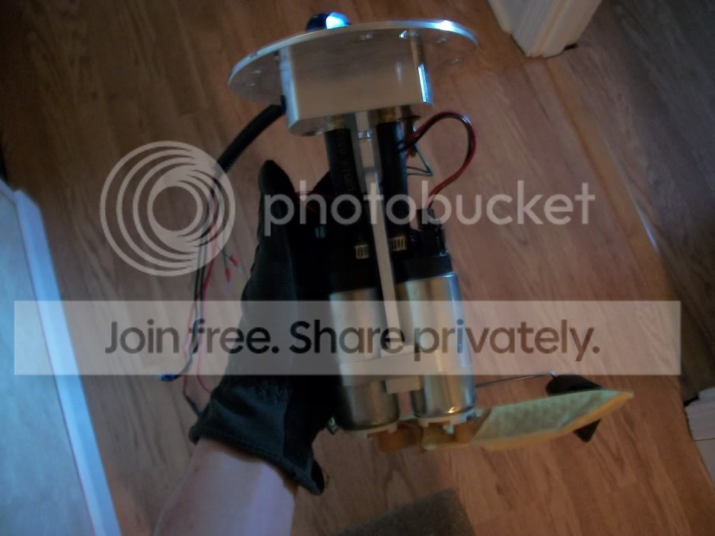

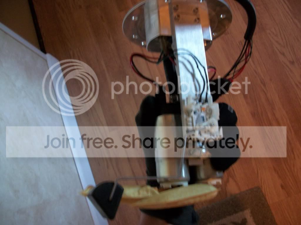

Fuel Blown dual Walbro 255 fuel pumps

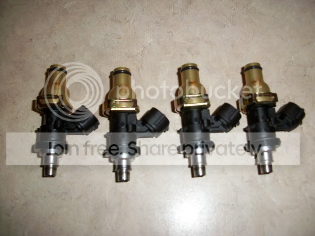

ID2000 fuel injectors

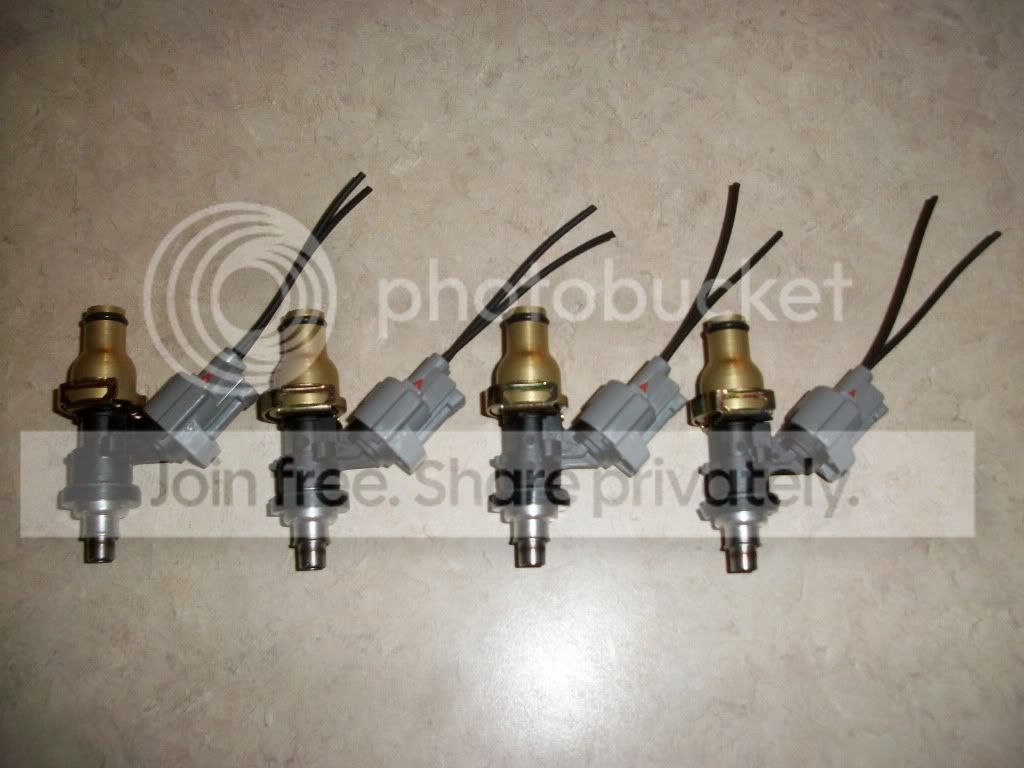

ID2000s, compliments of Tony at T1

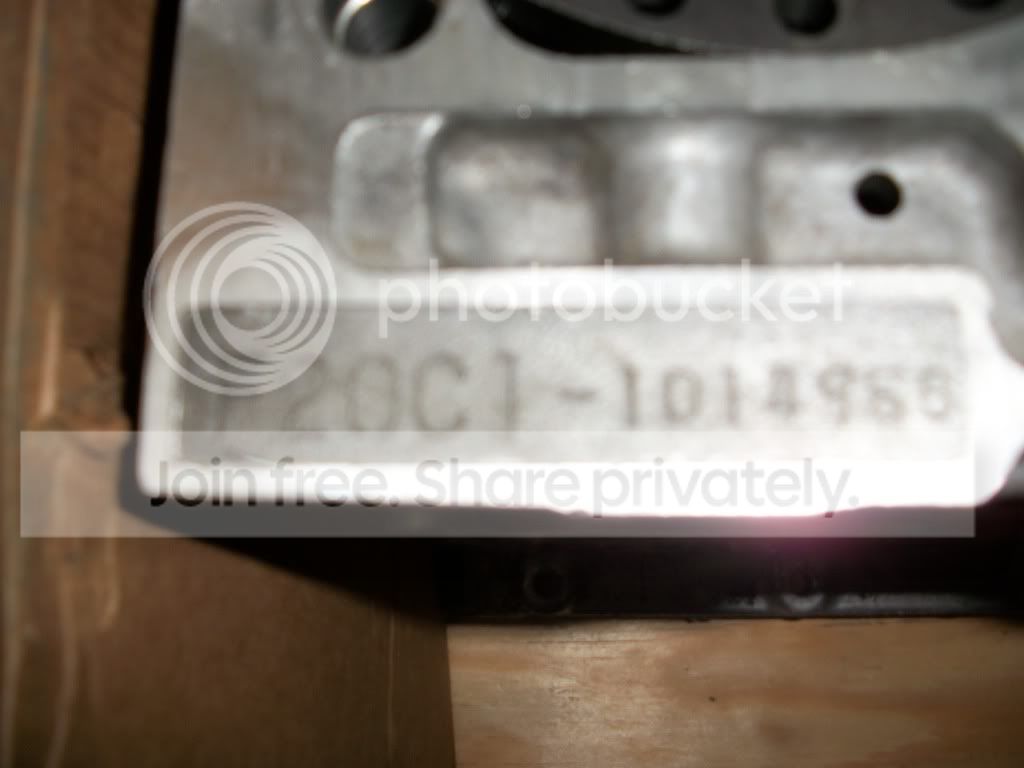

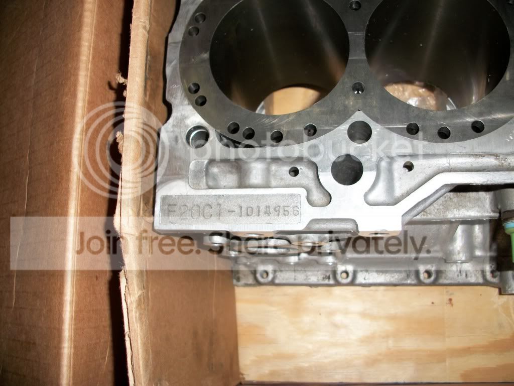

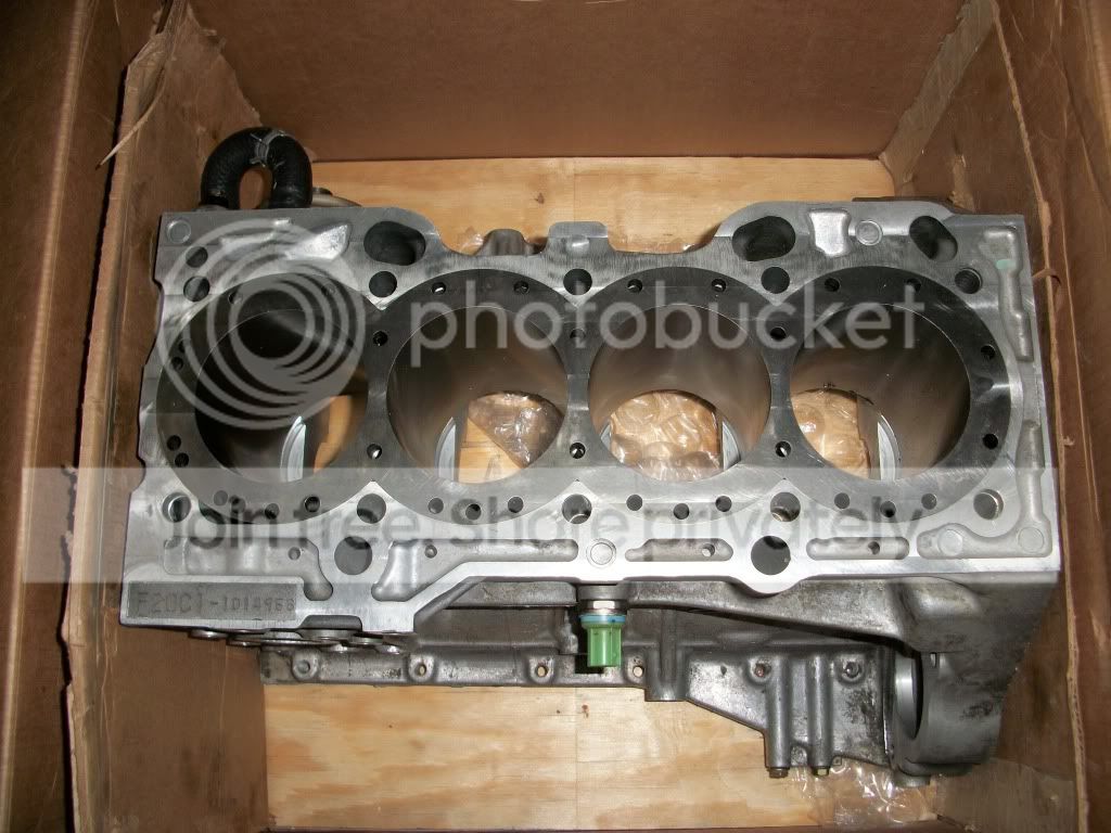

BLOCK HAS ARRIVED:
5th turbo change, hopefully the last:

Full Blown Walbros

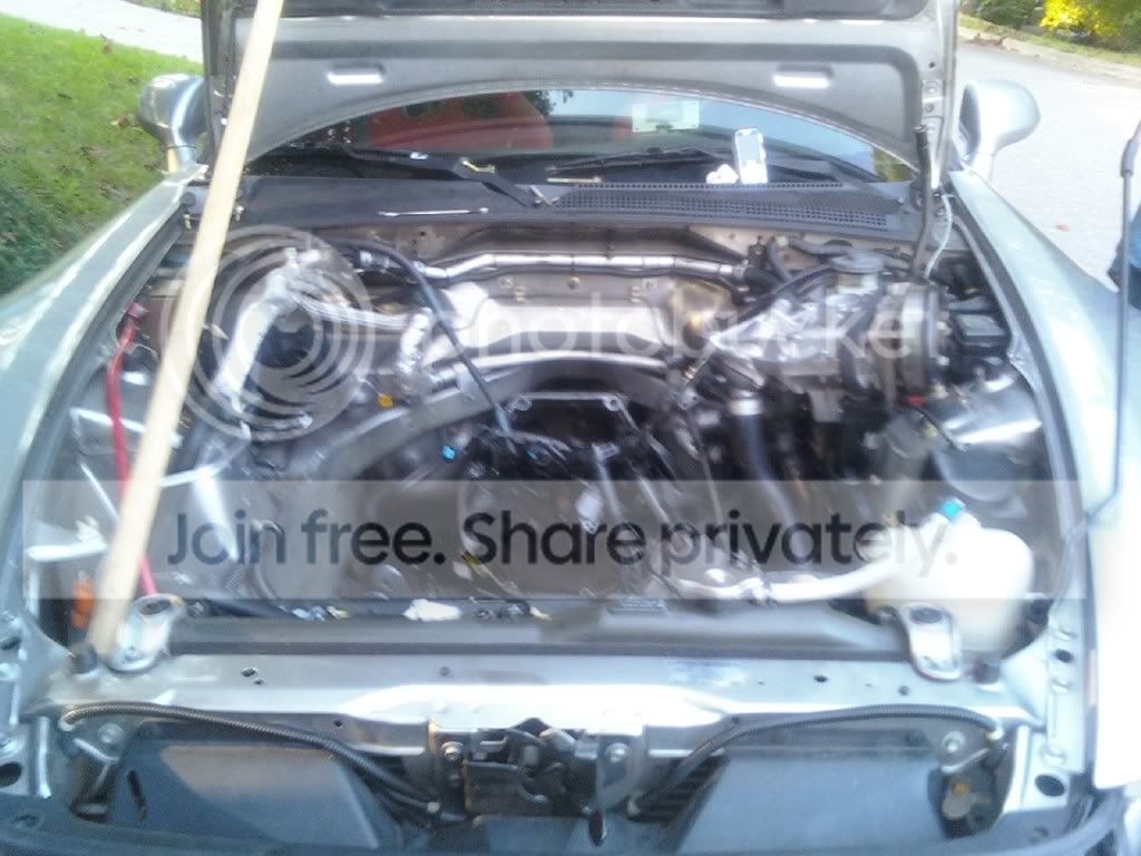

Before:
Now(preposted, I know)

Casey's ballin ass fixin to stuff the motor in the mailbox

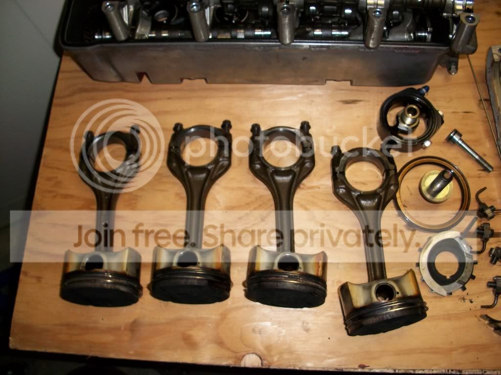

For those wondering, yes the stock internals are fine.

Nice.

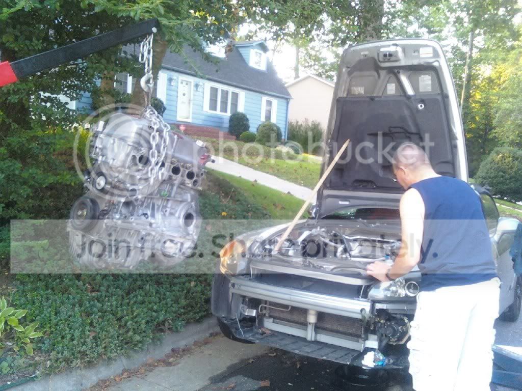

Gangsta pullin the motor right in the street.

Haha thanks guys thats just how I roll I guess. Really was a batch gettin the motor off the tranny without a lift. Its in a private neighboorhood so the only people that bitch are neighbors, but I havent neccessarily been known to care about what some of them say
Howd you manage to get a ticket for flippin somebody off? Should have told the cop it was just your friendly way of waving
I took the motor to Darius from Driv3n and he is the one that took it apart to send the bare block to AEBS. He will reassemble it and Ill put it back in the car, then bring it back to him to be tuned.

Tree + engine pull on the side of the road = definition of a shade tree mechanic.

everything else looks good. including doing the motor swap in the street lol

Lack of garage = yank motor in road gotta do what I can
