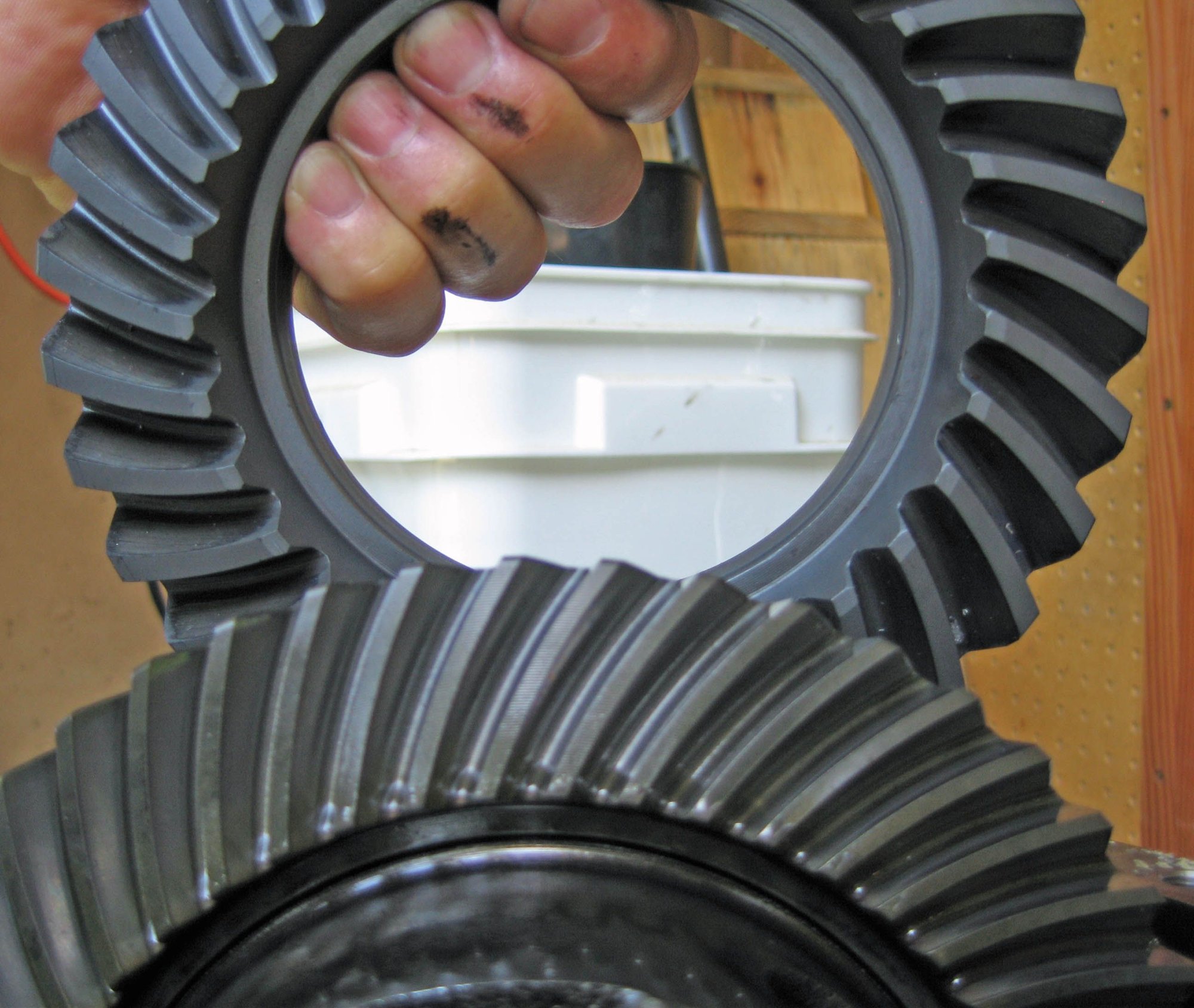

If anyone is wondering why the Nissan is so much stronger than the S2000 diffy, here is a picture and some numbers:
The ring gear I'm holding is Rick's 4.56. It's diameter is approximately 7 1/4". The Nissan is approx. 7 7/8". The length of the teeth:
Nissan - 1 7/16"
S2000 - 1 2/16"
I'll be switching to the Nissan in a few months.
