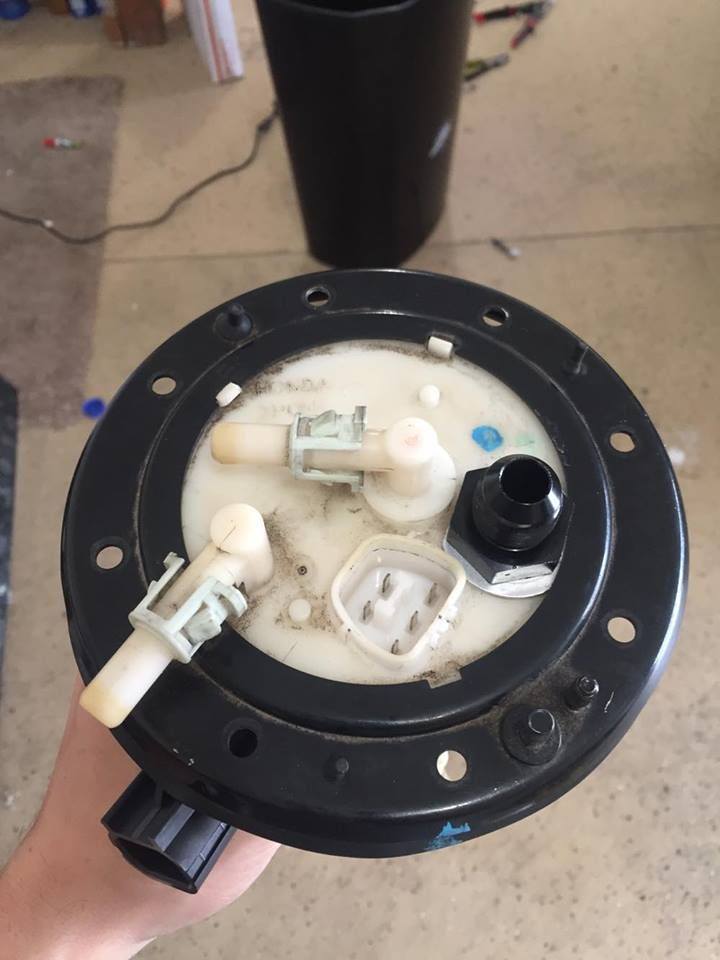

My fuel setup, 450 intank, with direct -8 from pump to rail. no bottle necks. Full blown rail, and 1650 FICs -6 Return and flex fuel sender wired into EMS V2.

im already on e85. Aem 320 e85 pump, dw1300 inj, aem fuel rail and aem fpr, with oem return line back to the tank. How come you didnt run the feed from the oem port on the fuel pump housing? Did you just cap off the original port?

Wanted unrestricted flow. It bottlenecks down pretty small. So went -8 all the way.
So 8 feed and stock return?

Yea stock return, can't go blow 40 base fuel psi, so works I run 45 anyways
