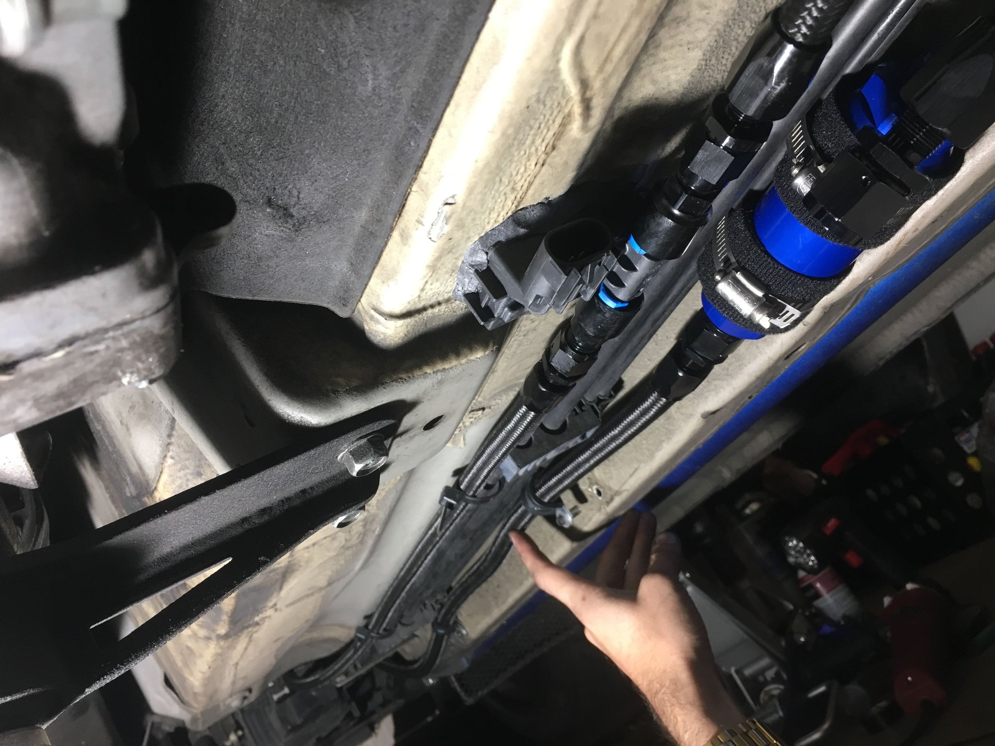

I'm running twin Walbro 450s on a FBM hangar, -10an feed, -8an return and ID1700 injectors. the -10/-8an combo is a little overkill seeing as there are plenty running the -8/-6 combo. I have my sensor plumbed under the car near the fuel filter I have in the feed and everything is zip-tied up because the big lines won't fit under the factory plastic.

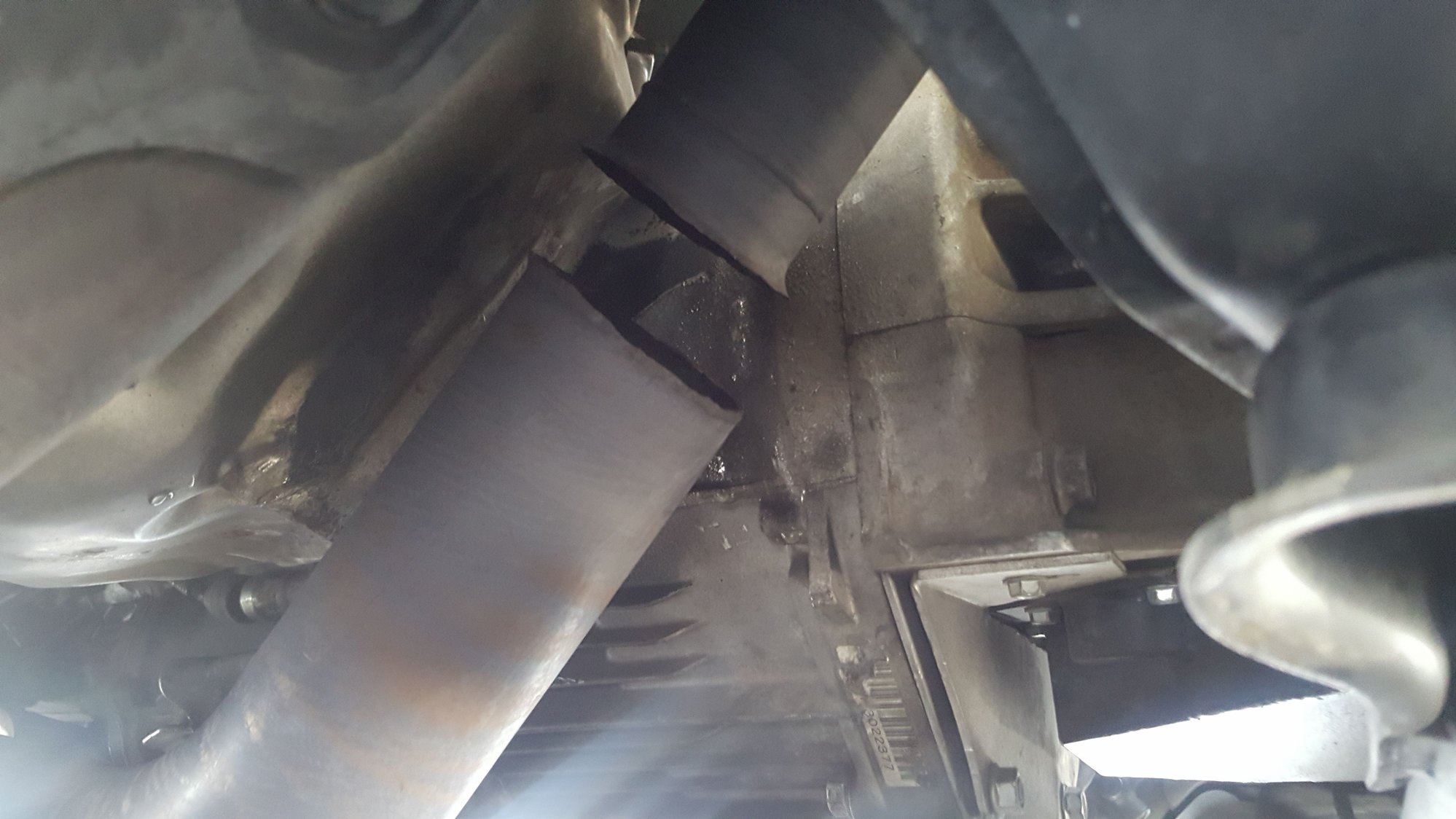

​​​​​​Don't go e85 too much power it will blow up ur downpipe. Kakka

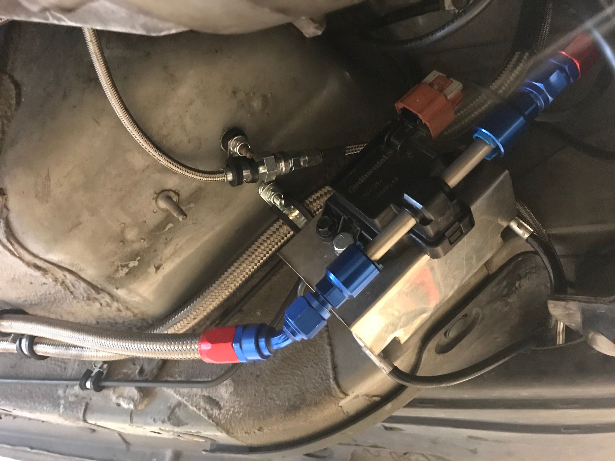

I made a bracket to mount it on -8 feed and -6 return.
Thats the same spot where we place my flex fuel sensor. I'm using stock fuel line tho
