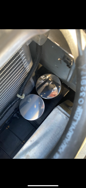

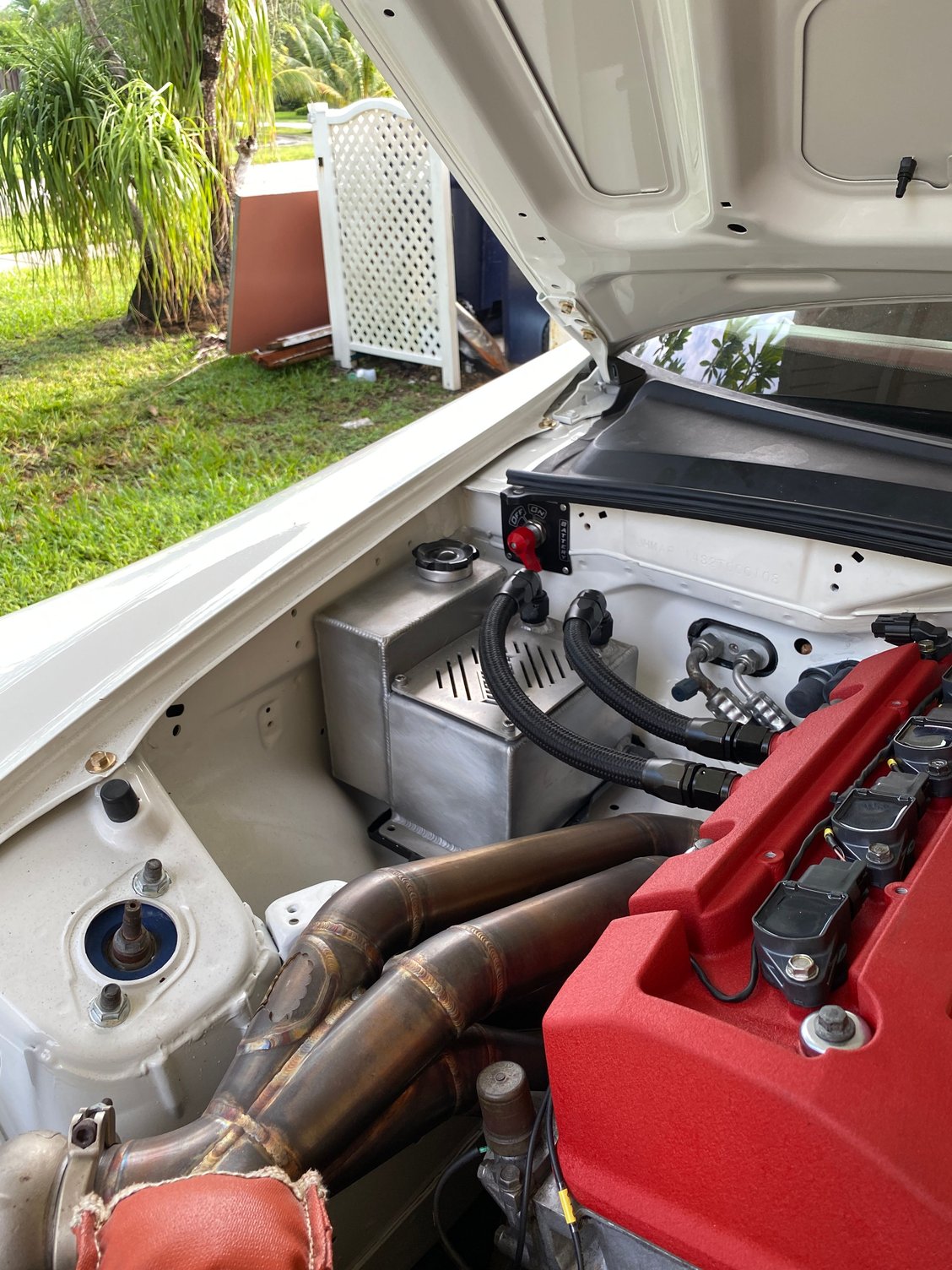

Radium 00-05 dual setup (to keep my cruise). Both cans are vented. I'm not particularly happy with the hoses, so I'll be redoing them now that I got a much nicer VC on the way.

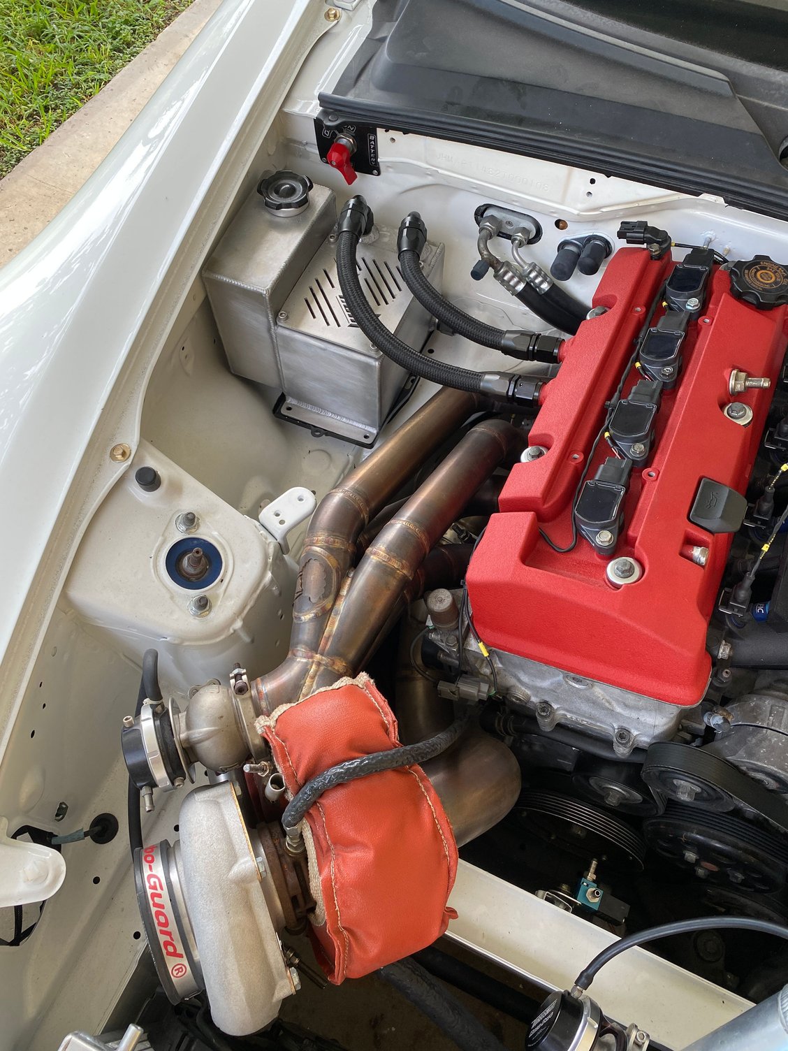

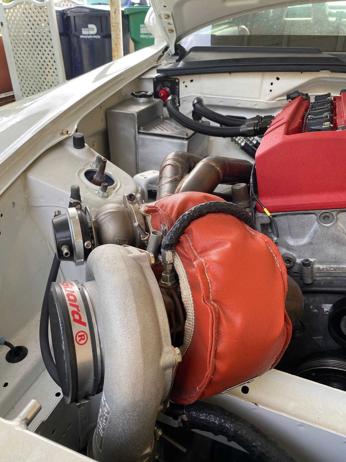

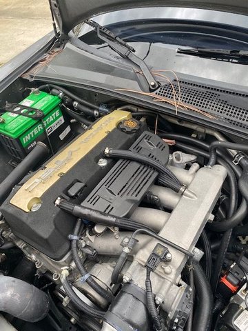

Here's my basic catch can setup, does the job and no more dipstick issues
Catch can $60
Hoses, fittings and bracket was about 45 bucks

Joined: Aug 2009
Posts: 814
Likes: 37
Super clean.. GPW
