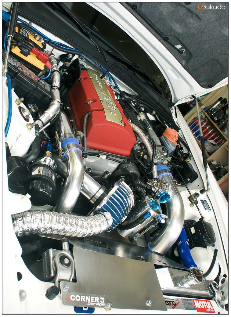

asukadc's Avatar
Joined: Mar 2006
Posts: 3,248
From: socal
dual can setup, 2nd catch can ordered, will replace this one,
