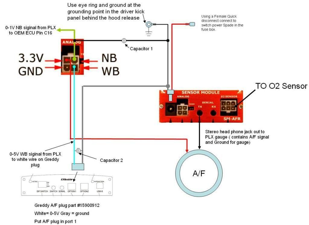

Yeah my timing might be perfect if there is a deal being worked out. I got my PLX stuff last night. I bought the led multiguage and I think it will look pretty cool. They have downloadable gauage faces and one that matches the S2000 in color and style. I just need to figure out how to hook the darn thing up.
The instructions might as well say "install" because they are almost that short. I need to spend some time on the PLX forum to see how it is hooked up to the Emanage.
For anyone that has run a wideband harness into the cockpit, any tips appreciated. I don't know if there is a good spot to pass the harness through or if I am supposed to look for a spot and drill.

Here you go Vader wiring diagram for the PLX wideband.
Since you are going to replace the factory O2 sensor either you need to wire up a resistor on the OEM plug or just leave it plugged up but ZIPed tied up out of the way.

Awesome Mark, many thanks.
I think I will not have to run the 3.3 volt to the guage the way the LCD multi guage works, but I should be able to make it all work with this diagram. Very helpful.
I will have to locate pin C16 on the factory ecu, would I splice into that wire on the Boomslang harness or replace the wire in the boomslang with this one?
