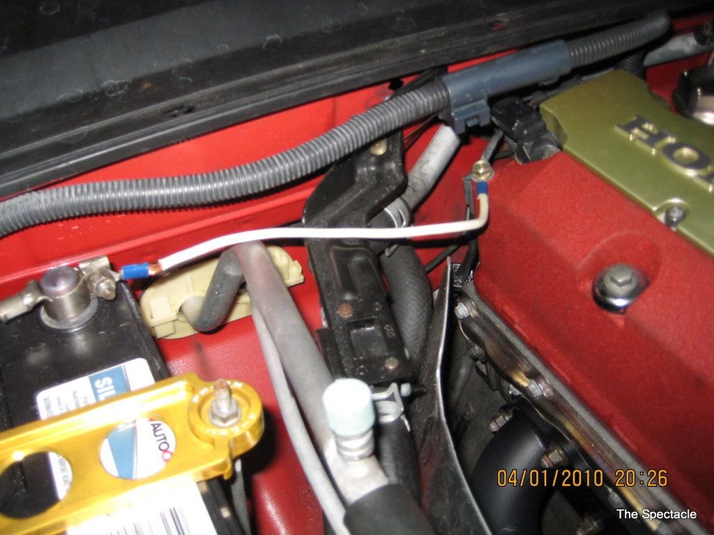

I also solved the issue with my Kpro disconnecting during a pull. There was no ground on the valve cover and the laptop wasn't on the same ground loop as the ECU. This let the USB port on the laptop pick up all sorts of noise and would kill the connection. I grounded the valve cover to the battery and plugged the laptop into the car via a AC-DC convertor and the connection holds rock solid as its supposed to. In addition to that, solved an issue with the PLX not showing correct in Kpro by removing a two transistors within the ECU. AF now reads correctly.
