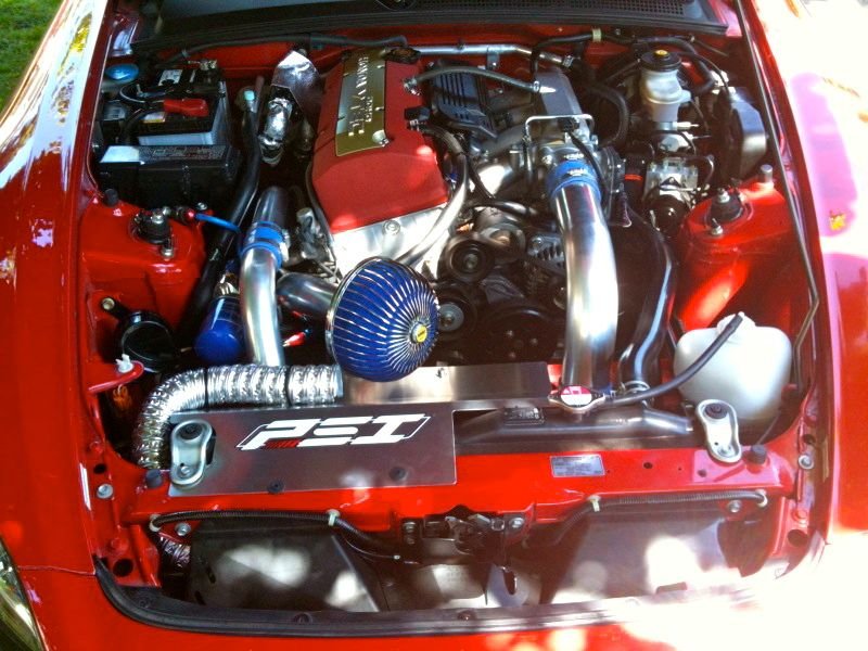

The kit and install does look very nice.
Glad youre happy with your numbers. Go out and enjoy it but be ready for the boost and power bug.

looking good!
mine looks very similar to yours...

very clean engine bay..I like it, makes me want to order this kit....

anyone with this kit change the oil filter yet? Looks like a big mess waiting to happen. Is it?
I've done a few oil changes already, not that bad. I suggest placing a rag under the filter so it doesn't drip down when the filter is removed.

pretty good results
staying below 10 psi is good with the stock MAP sensor. If you turn it up, make sure you go with an upgrade map sensor as well. If you don't, you're get a CEL for exceeding the sensor.
if you go with testpipe or high flowing exhaust, you're boost will increase. The tune and powerband looks great.

Get the test pipe, upgrade MAP sensor; stock isn't accurate, even below 10psi.
Have fun!

Anyone try one of the HFCs out there? And how about a rec for a MAP upgrade (brand)?

my buddy has a hfc on his car with the greddy kit. He is also an 06. With the highflow, he is getting 10+ psi. He has the 70 em dual exhaust as well so that will account for more boost as well.
as for MAP upgrade, seeing you have the flashpro, I would get the hondata MAP sensor. Not sure if SOS map sensor will work with flashpro. I don't see why it wouldn't.

Oil changes are super easy. Just wrap the filter with a plastic bag, and take it off. Any spillage goes into the bag. Oil changes take a few minutes now.
Just trust me and take my advice, find my thread on greddy kit mods and follow them all. It will make your kit bulletproof. Total mods will cost you less than $100, and save you tons and tons of headaches.
