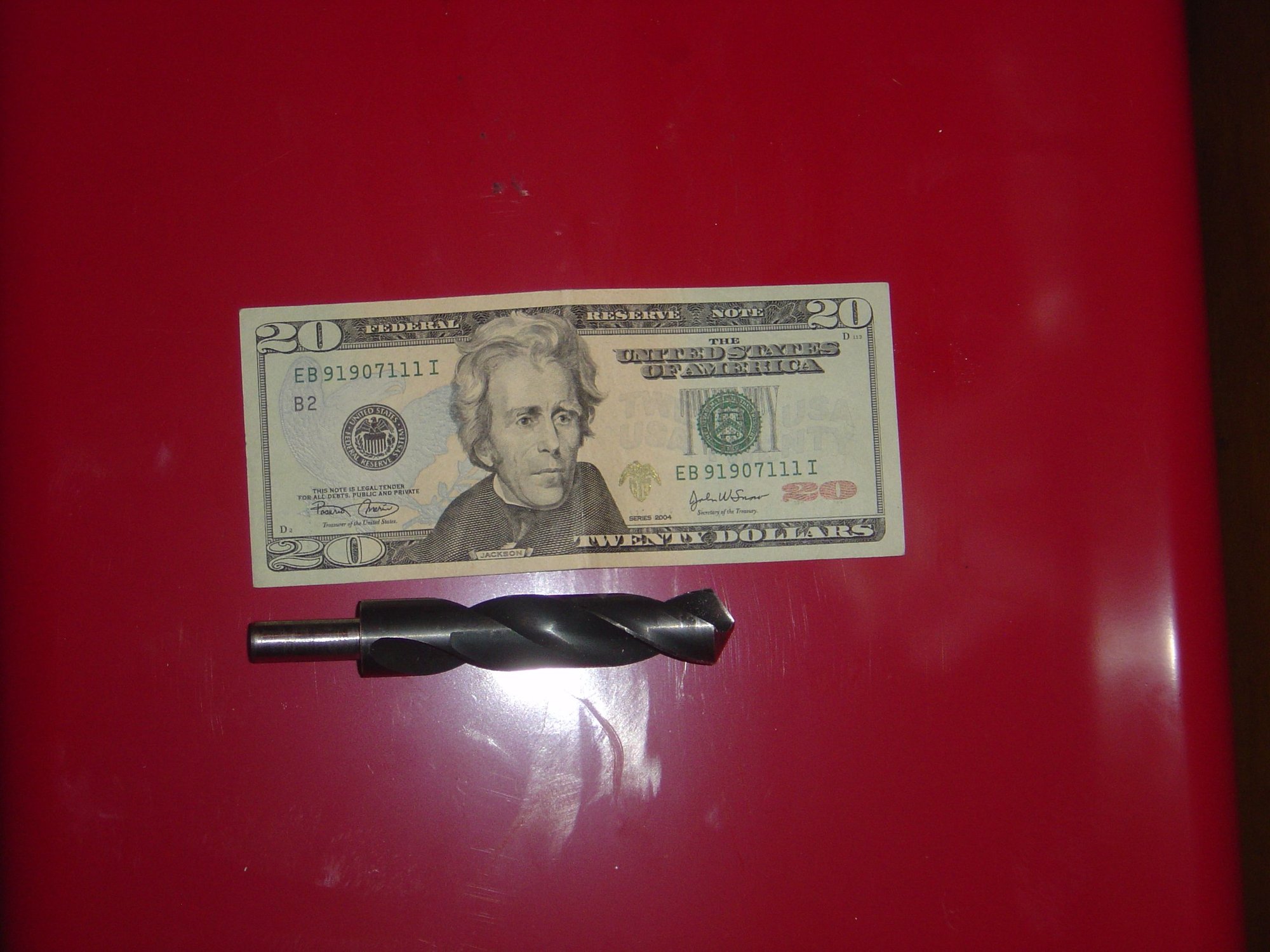

Thanks for all the advice guys.. I ended up taking the drill bit to a local machine shop and had them cut another 1 1/2" off the flute end and resharpen it.

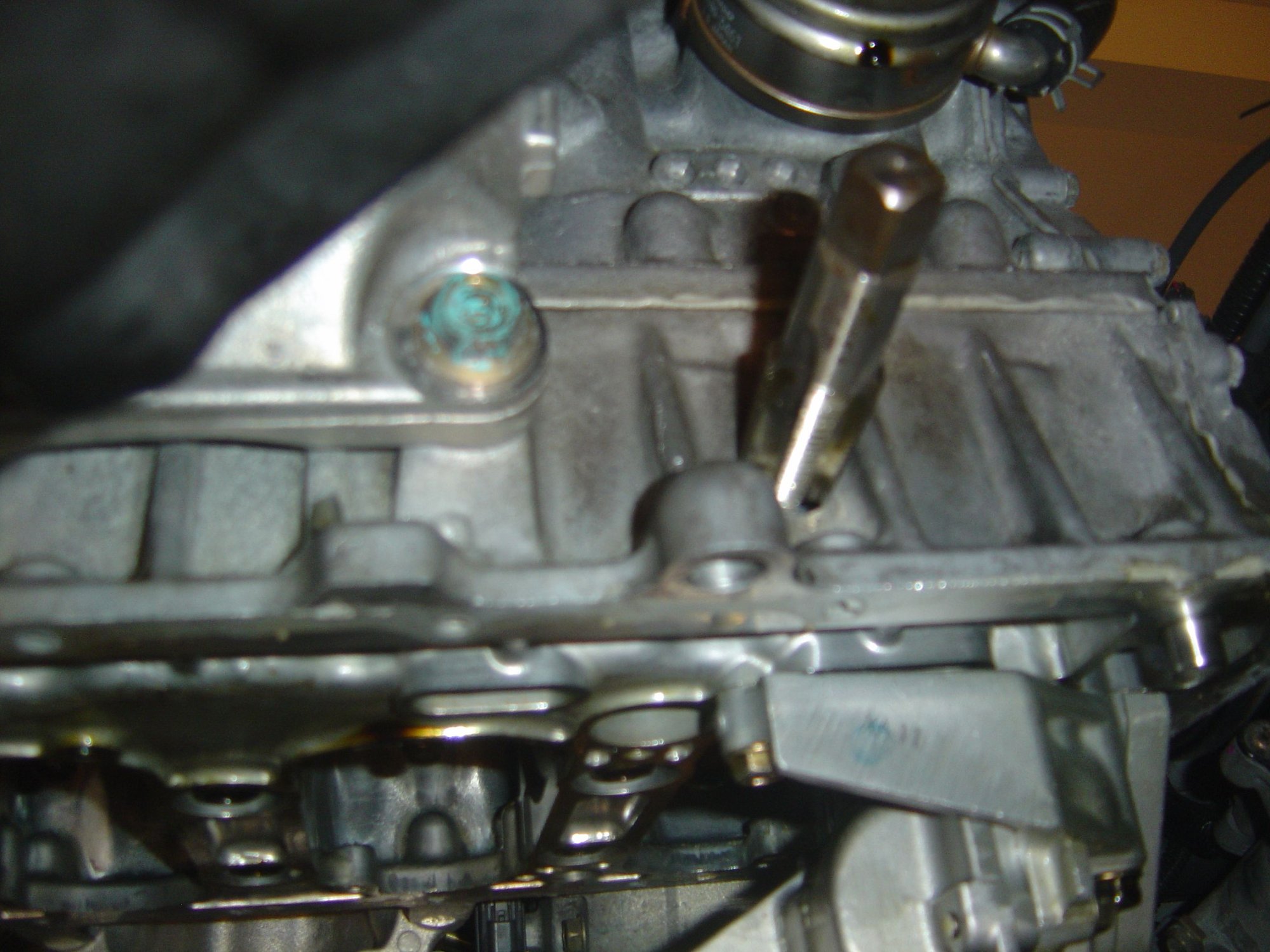

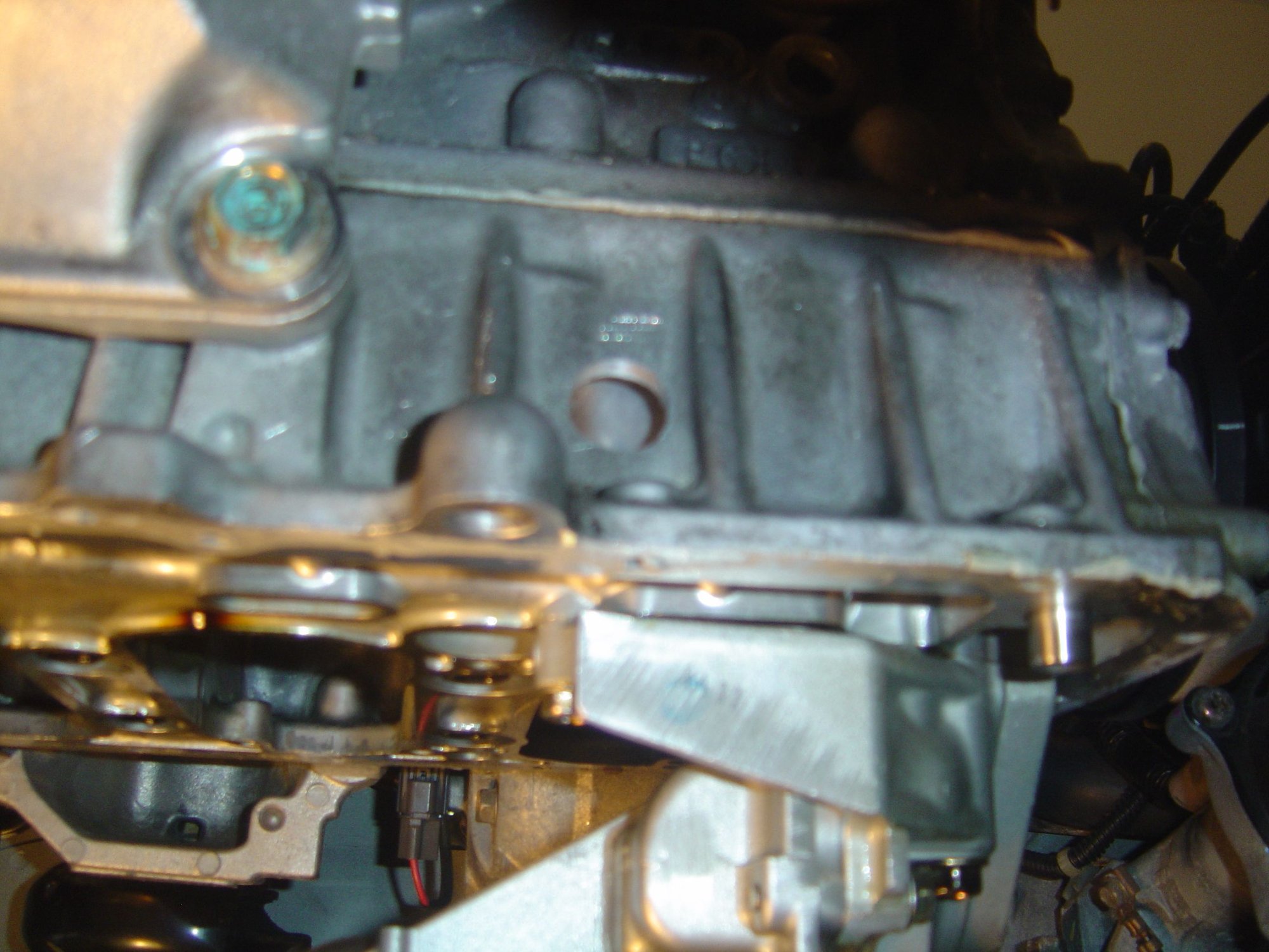

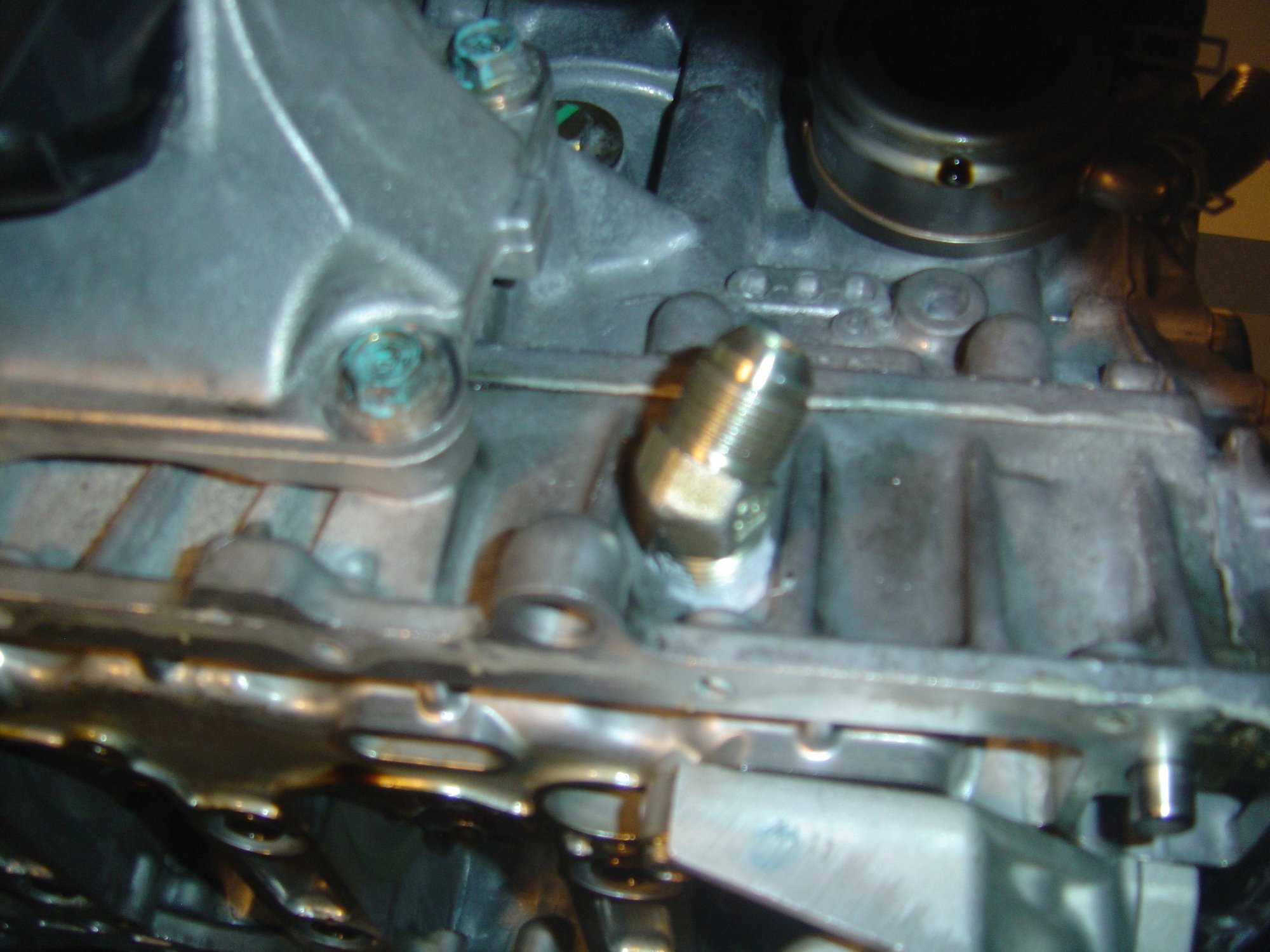

Finally after all our work Jeff and I finished tapping the girdle, it was hard finding a solution but now that we did you guys and girls dont have to go what we went thru here is the easiest solution take the drill bit to a local machine shop and have them cut another 1 1/2" off the flute end and resharpen it.
And here are the pictures, sorry for the POOR picture quality but all my $ is going on my car not camera
After we drilled
Threading it
Installed fitting
Ready to go
Hope this helps you guys.

is that a brass or stainless fitting? can't tell by pic. Use Stainless.
