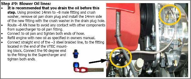

Originally Posted by 73Zero,Apr 18 2007, 02:07 PM
Believe it or not, I think the way you've installed your Comptech oil drain is the way to go. Like I mentioned in my earlier post, if I could do it all over again, I would've tapped into the block like Cherry04 did.
Just for reference, according to Comptech's instructions, the oil pan drain plug is supposed to be replaced with the provided 14mm to -8 male fitting. The actual drain tube coming from the back of the blower is then supposed to be connected to that fitting. I believe all the Comptech kits were installed this way, but I'm not sure (the earlier kits may have had different instructions). Here's a snapshot of the Comptech instructions:
The only supercharger kit that I'm aware of that required you to drill and tap into anything was the Vortech. To install the drain on the Vortech, you are instructed to drill and tap into the oil pan. I believe the Vortech kit even came with a drill bit for the drilling.
Thats the feed line. Or were you just pointing out the caption in the text?
