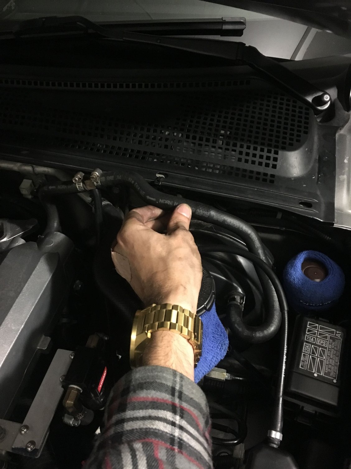

What is the best place to tap into for a vacuum source for a bov. Right now I have it T into the brake booster... if I run 2 bov on my Ctsc what should I use for a second vacuum source?
Also can I replace this hose (the one I am holding in the picture) with standard fuel line from Auto Zone?? The OEM hose has directional arrows on it and feels like it has plastic or metal inside the hose..... maybe to keep it from collapsing.

You cannot replace the hose with one from Autozone. You need a specific brake line because the "metal/plastic" you feel inside is a check valve so the brake pedal doesn't fall when you turn off your car.
Strange how I've had the brake booster disconnected and my brake pedal has never fallen.
