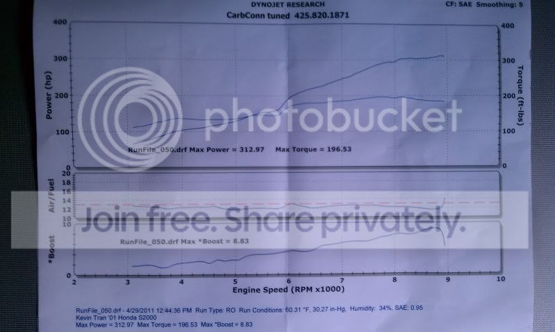

Ok thanks guys I have both the missing link and hopefully the esm overnight so should have them tomorrow.
I will hook the belt back up, box removed and install the missing link. If there is improvement than I will hard wire the esm and go from there.
S2000junky- you might be my new tuner. I am gonna be running a similar set up to yours if my set up right now works. I'll end up meeting you one of these days at the local meets.
Thanks again for everyone's help. Hope this works.

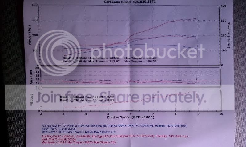

IT'S ALIVE!! Missing link worked. HP: 308 TQ: 196 8.8 psi at 8800 rpm
