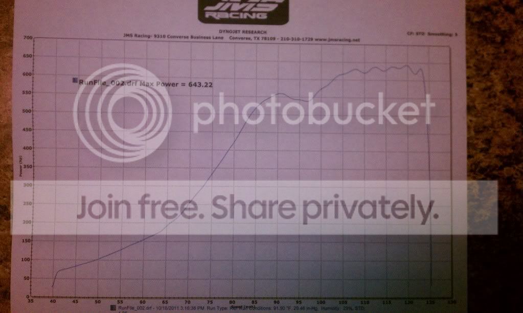

Ive seem alot of turbo dyno graphs were very skilled tuners have to set Vtec up in the 6-7K range. If you look at Log type turbo setup were vtec was set in the 3-5K range then you will see the jump in power after vtec has already been engaged for ~2-3K RPM's

Old Apr 30, 2012 | 02:16 PM
  #38
donaldmejr's Avatar
Joined: Nov 2008
Posts: 1,347
From: Pittsburgh, PA
Just a few I found
