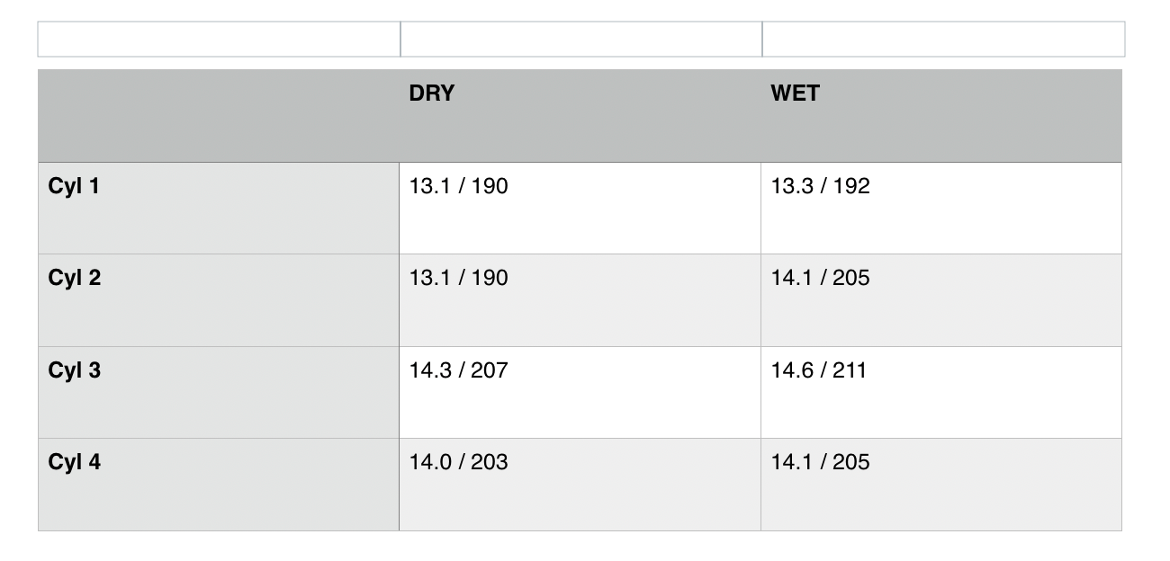

Also, I did a wet / dry compression test and these are the results. I attempted a leak down test a white ago, but it was sort of a disaster.

Condensation, completely normal.
Didn't see it before if your valves where not sealing the cylinders very well. AKA open valves during compression.
