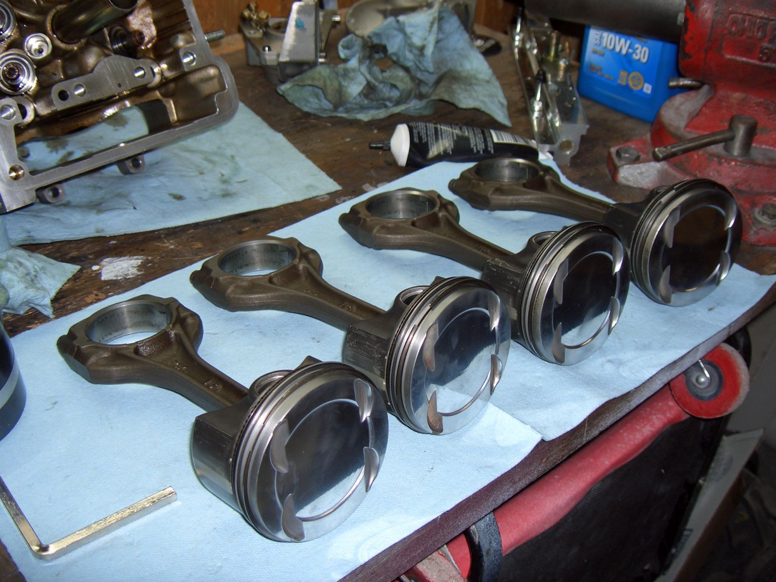

If you want to go low compression on the cheap, you can machine your stock pistons. Im running machined ap2 pistons at 9.6:1 compression ratio. Ive been running these since last fall. They have been very reliable so far, im running 15 psi at low boost and 20 at high, on 91 octane. Cost for machining is around $200. However the amount of labor required is much greater than just installing a head gasket. But at least you dont have to worry about your headgasket failing all the time.

how thick did the crown end up being on those moded stock pistons??
Also, i'd use ap2 pistons for that, ap1 pistons arent as thick under the dome

They wont make anything bigger than 0.25mm oversize, they say the FRM isnt consistent enough past that for it to be reliable in every block.
I should have my motor together shortly with the shorter NA pistons.
Also, looking at the moded pistons, it looks like they milled them down so the piston-deck is 0 (its hard to tell) Doing this effectively removes all the quench from the chamber, the piston needs to be 1mm out of the hole to work the best.
I measured the dome thickness of both f20 and f22 pistons. The f20's are actually thicker. Honda used the same rear forging die when making both pistons, the top die is the only thing they changed in the forging process. They actually have alot more material in the piston than is needed. I beleive the reason for this is that it is difficult to go very thin using a forging process.
ap1 dome thickness = .340 inch
ap2 dome thickness = .265 inch
After machining, the dome thickness was around .170 in.
I only removed .005 off of the quench pads so they should remain very close to stock. The majority of the material was removed from the center of the piston.
