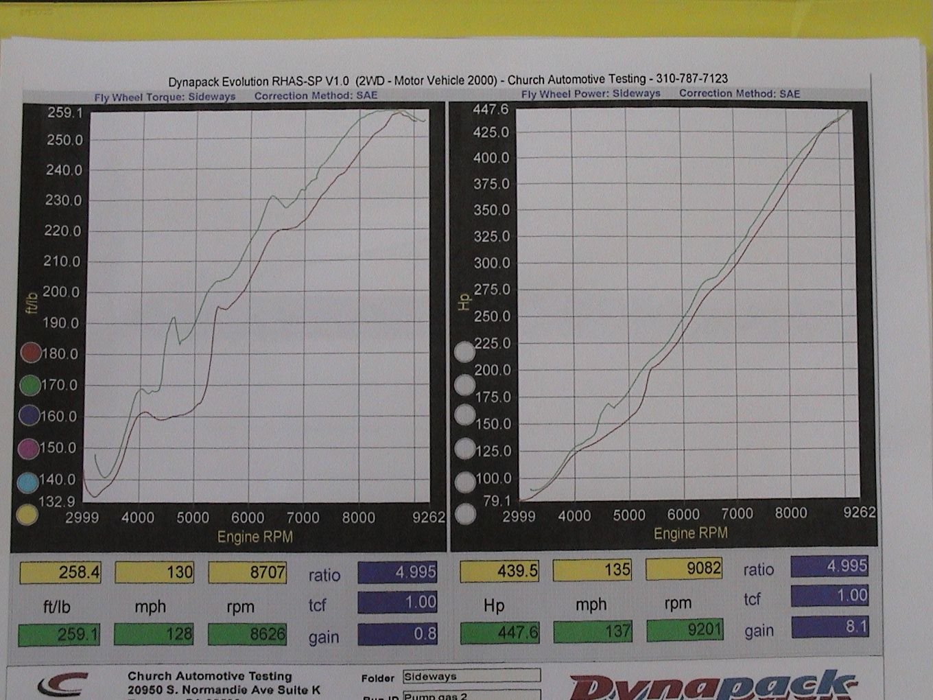

I'm back to the 13 lb pulley, I don't want to blow this engine.
Shawn tuned it to 91 octane and dropped the V-tec down to 4000 rpm. I've added a new fuel pump and lowered the FP to 55lbs. Picked up considerable torque midrange and a few ponies up top. 447 rwhp and 259 ftlbs torque.
No dyno at 16 psi. As far as slipping or skipping, I feel ASP makes the best pulleys.

Nice numbers I am assuming that you're running stock internals, rods, pistons....
