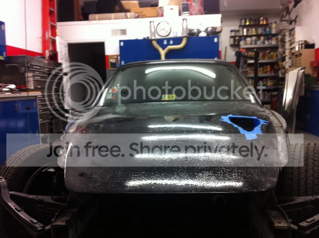

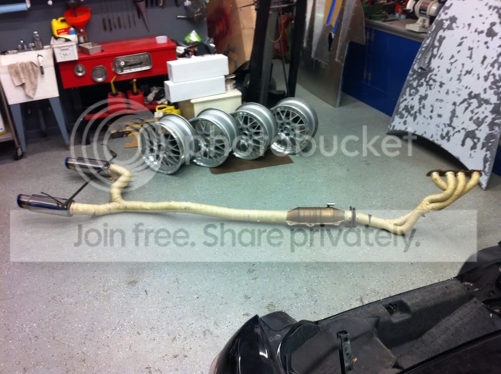

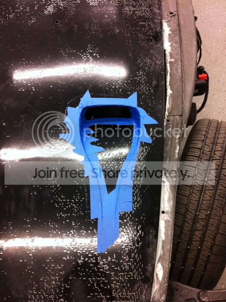

here is the final on the exhaust.. it is now done.
The hood is also done. Now its just rear bumper and engine bay then to paint.
Here is the exhaust.

this may be a silly question but, why did you wrap your exhaust?
Old Apr 27, 2011 | 09:28 PM

he mentioned he didnt want his aluminum diffuser to get too hot

I would still like to do the rear mount one day.. but that is not for now. Yes the wrap is for the aluminum in the rear. and for the headers I had extra from finishing the header back piece, and I thought I have always liked the look of the wrap on headers when done nicely so I went ahead and did it. Also it is always good to keep the engine bay temps down.
I am very curious to see how loud the exhaust will be.
