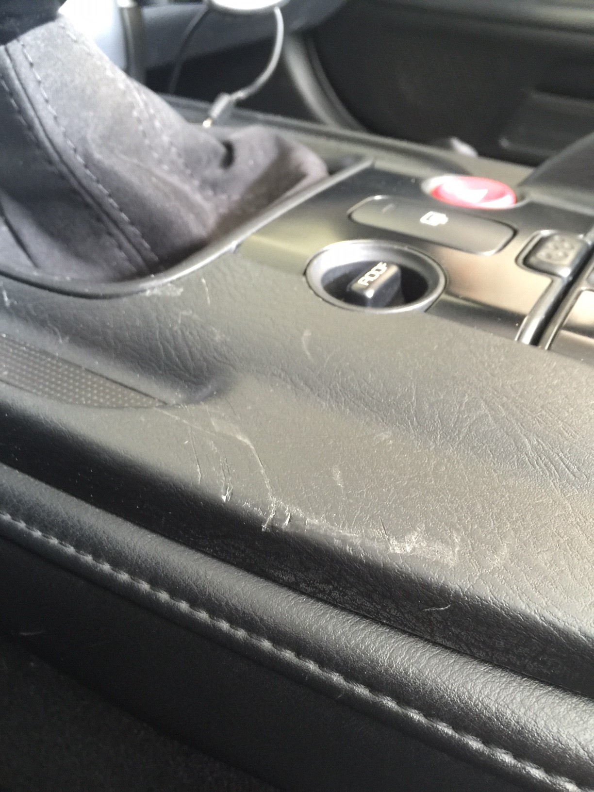

Thanks for the input, I think that might work with some fine scratches or the like, but in my particular case the plastic is more gouged than anything. I will take some pictures to see if I can show what I am working with.

Here's a picture of the affected area

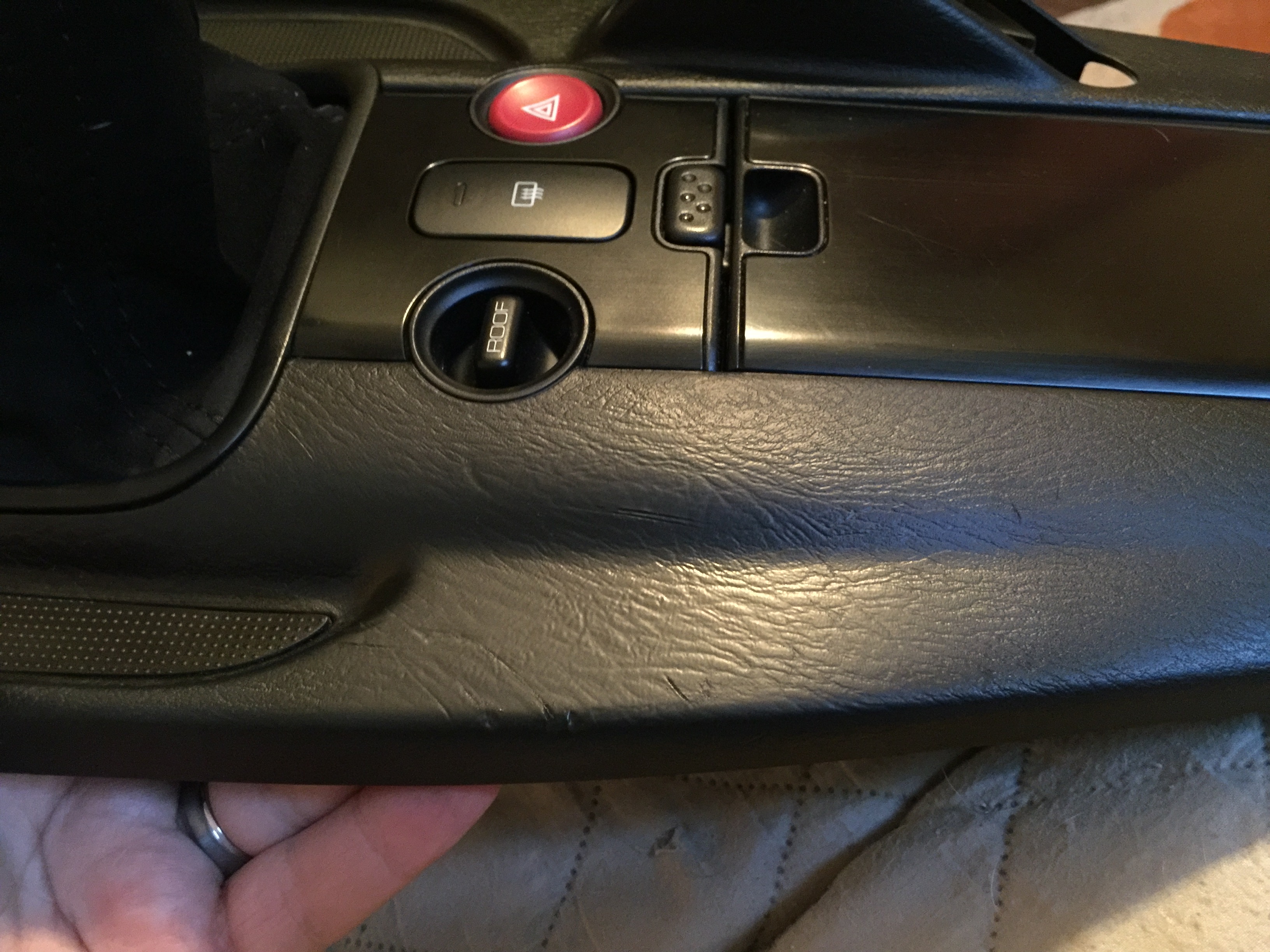

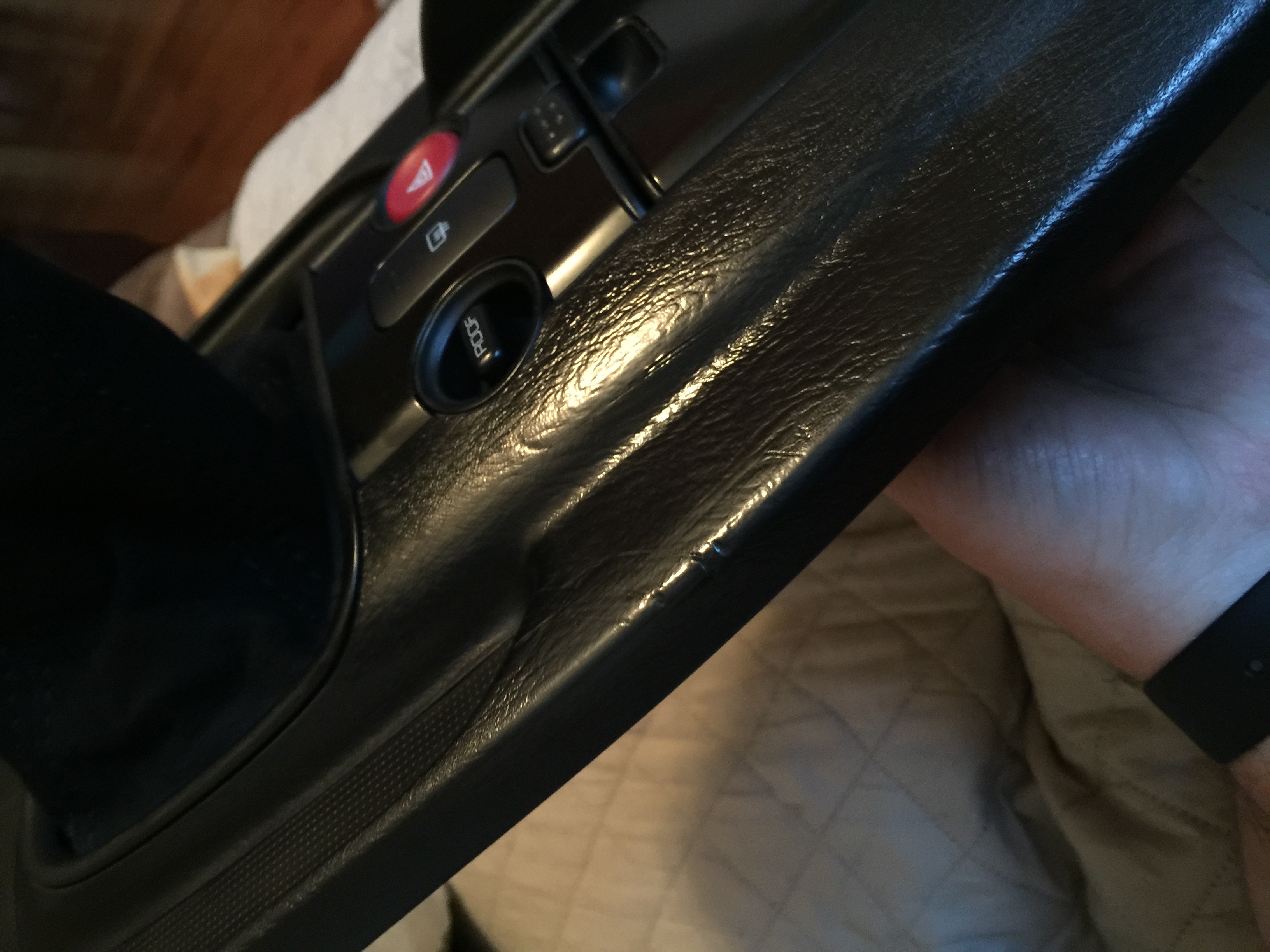

So I tried the heat gun route, it certainly minimized the visibility of the scratches but it left the plastic "shiny". I then used a Magic Eraser to scuff the finish and return it to the same look as the rest of the console. For now it's an improvement, but eventually I'll just replace the whole thing.
