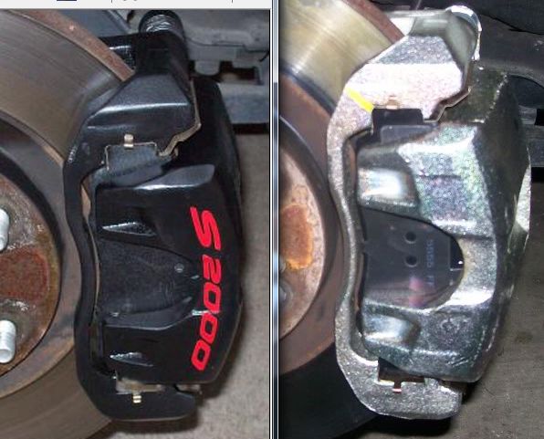

These are the Accord calipers on the left and CL calipers on the right.
Edited for stupid question I asked.

^ i believe that is correct. the left is picture of the OP who said he used 03-07 Accord V6. the right is 01-03 CL. they look just about the same. brakeexpert told me that the difference is the coating, the CL has the zinc coating and cost more. but they both use the same bracket, so the offset should be the same.
