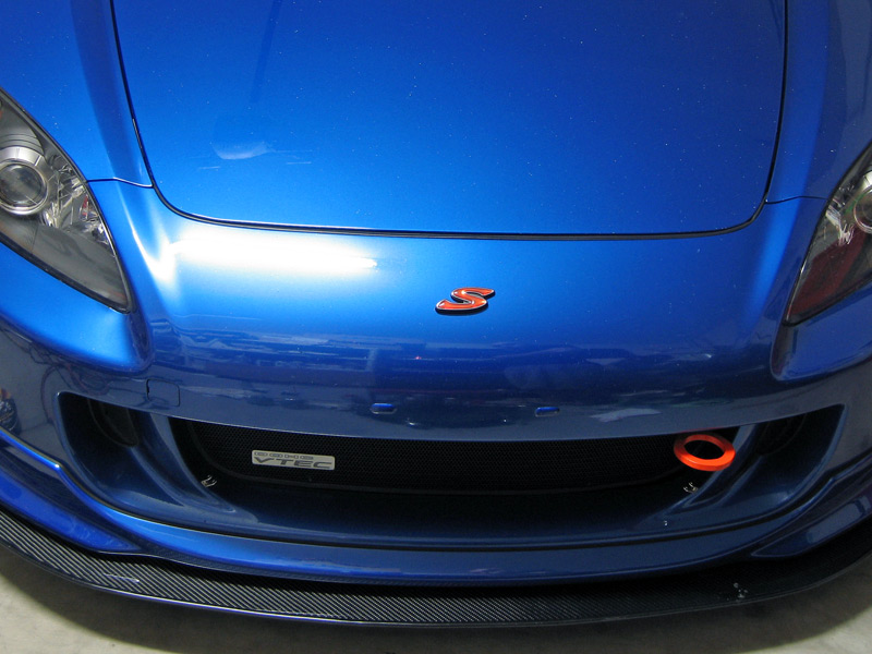

it looks like it connects to the front bumper but that doesnt make sense cause at high speed it would rip it off. where does the back hook up to? anyone have this and like it. can i hook it up with a oem lip. btw this is ap1. please no comments saying i dont need one unless i see heavy track use.

the mounting points line up under the car. it'll make sense when you get under there. you can mount it as deep or as shallow as you want.
you need the stabilizer bars though to ensure it has maximum support and doesn't rip off. make sure you get those if that's what your worried about.
i've seen it done w/out it them, and it looks clean. but for any sort of performance in mind, you'll want the stabilizer bars.

It comes as a single piece with no holes so you decide how far out to mount it. I attached it through the stock locations with extended bolts and washers. It's very solid but you can't stand on it.
if function is your objective, you'd want it further out and w/the stabilizer bars. but that *looks* good there too
