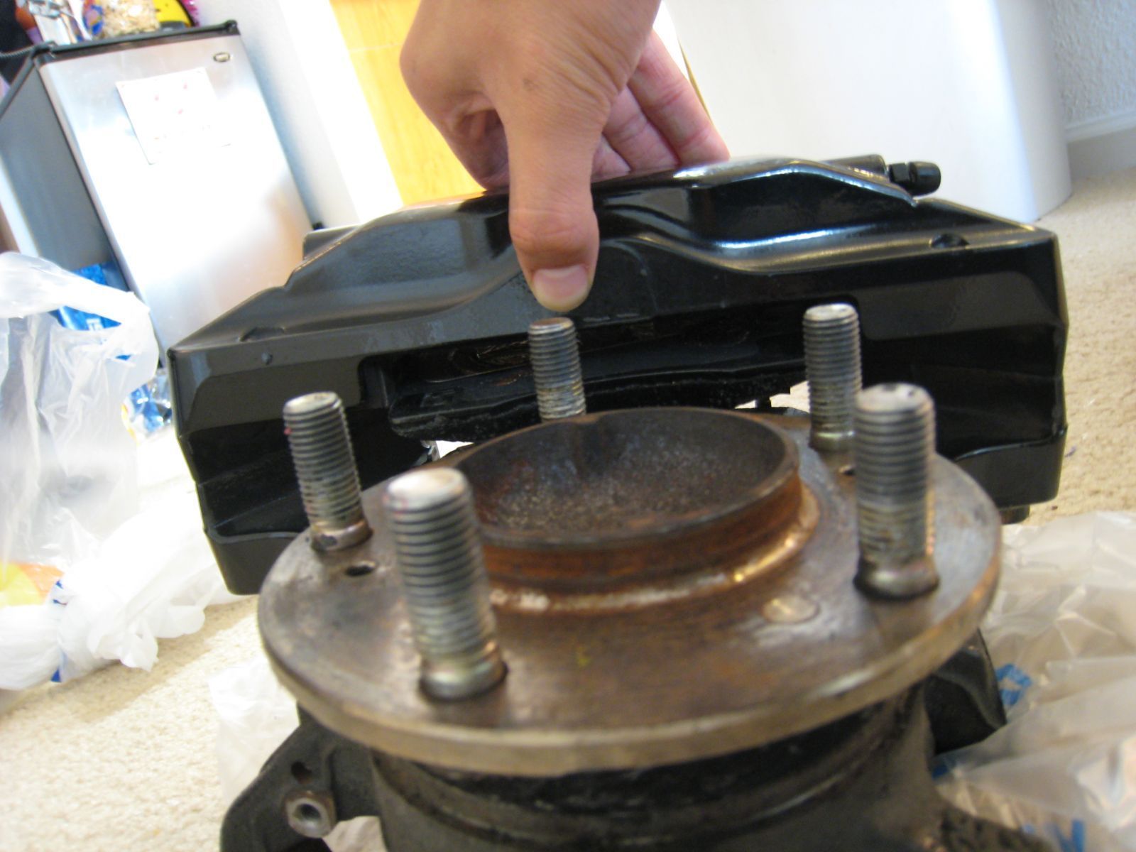

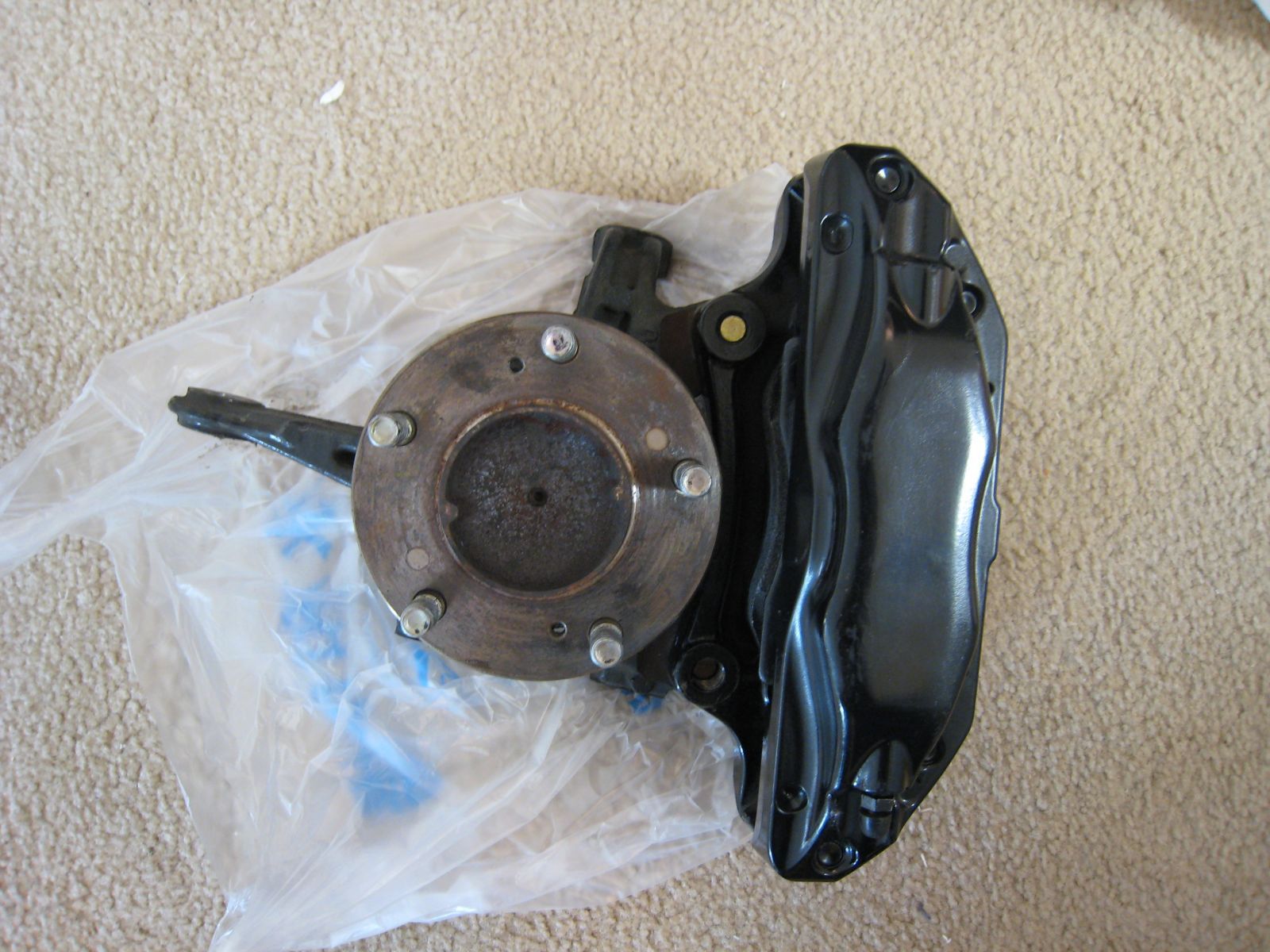

got the knuckle caliper holes widened to fit the bolt!
idea of how much caliper i'm gonna need to clear

hmmm looks kinda weird without anything on the caliper. maybe you should get a brembo or Honda logo put on there. it'd look sick with a Honda one!
