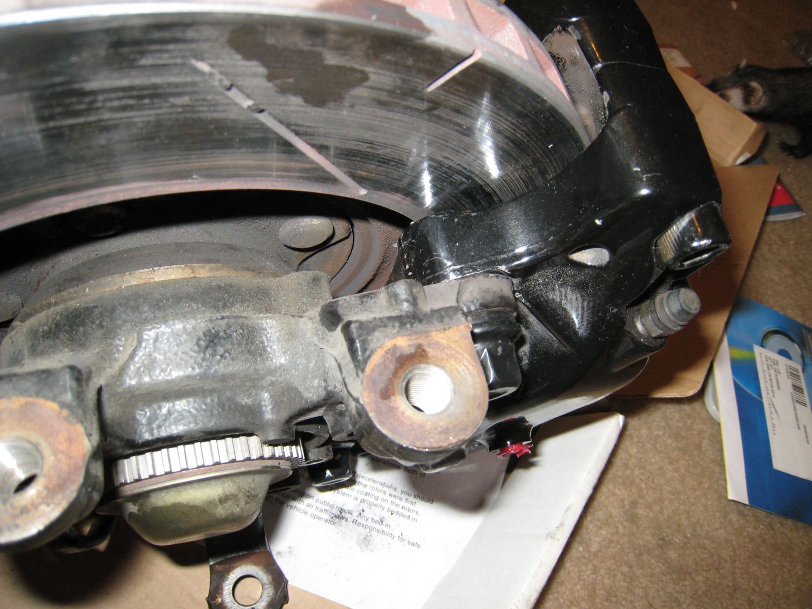

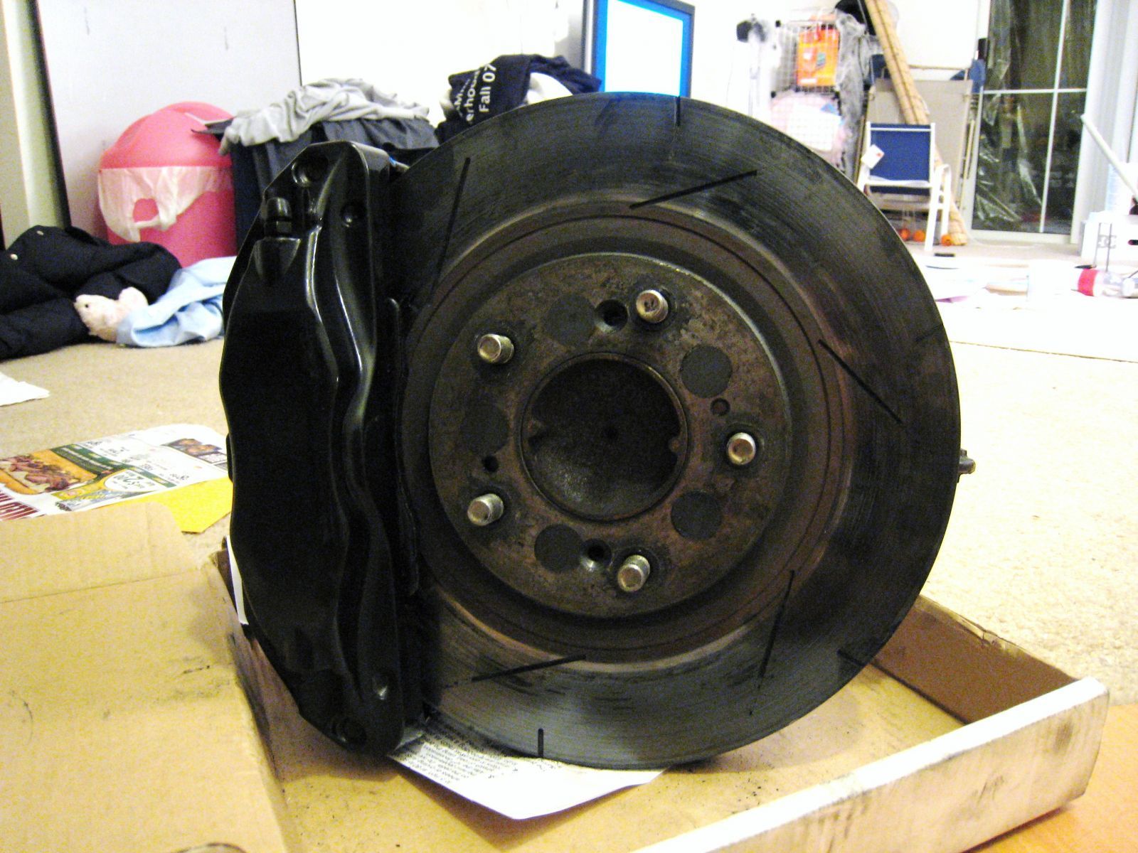

[QUOTE=nightcrawler7188,Oct 22 2007, 12:41 PM] hmmm looks kinda weird without anything on the caliper.

OOO huh?
one problem..
looks like the pad is larger than rotor surface so i'm going to go to acura tomorrow and get a rotor for the TLs to see if it fits better, then if it still doesn't fit, i'll have to shave off some of the caliper bracket..geez so much work >_<
Old Oct 22, 2007 | 08:13 PM
  #56
nightcrawler7188's Avatar
Joined: Oct 2005
Posts: 10,158
Originally Posted by ericshun,Oct 22 2007, 11:52 PM
OOO huh?
one problem..
wow, it actually doesn't look bad at all now that i see it on a rotor!

Can you measure from the rotor to the outside of the caliper to get an idea on how much space is needed for wheels?
Thanks for stepping up and doing this. Looks great.
