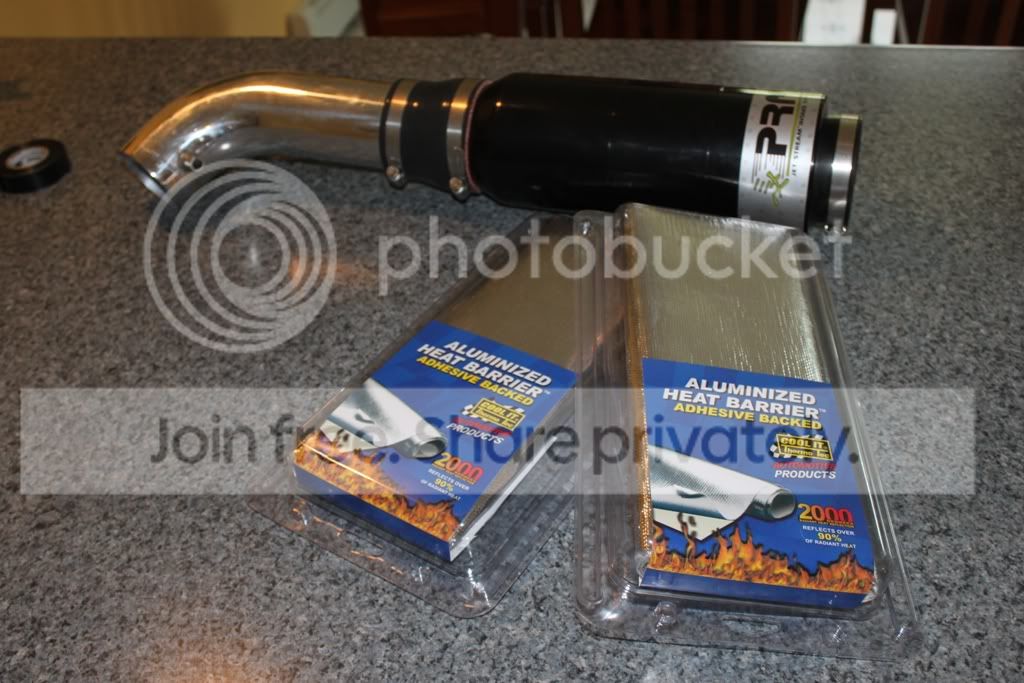

Thanks Gernby. I am actually not data logging soft dyno pulls as I think those would show "meaning less" results.
I am logging, IAT, Coolant temp, Engine RPM, Engine Load, and speed. I think these are that areas that a difference would be seen in.
I set-up a 30mile loop that encompasses residential speeds, high way speeds, in-between speeds, and a stop for a time duration with both the car running and the car off. My expectation was to see a shift in IAT temps under each test condition...
From my observations during the drive, unmodified IAT seemed to average out about 120*F, thermal wrapped actually a few degrees warmer... BUT the IAT appeared to fluctuate very quickly and often with the Intake wrapped vs unwrapped. The more load the motor was under the IAT temps would drop very quickly where unmodified it seemed to just stay at 120*f or drop slower... Thermal wrapping seemed to help with heat soak too, it seemed to not reach the same temp after sitting in comparison to unmodified...
I will be looking at the data in the morning to confirm my observations... But my initial assessment, wrapping the intake affected IAT temps when the motor was subjected to load, and adding pulling air from outside the engine bay should also affect IAT temps...

Will do Hirev...
This is what I did today.... Ducting should be in Monday so I should be able to get it all buttoned up some night next week
