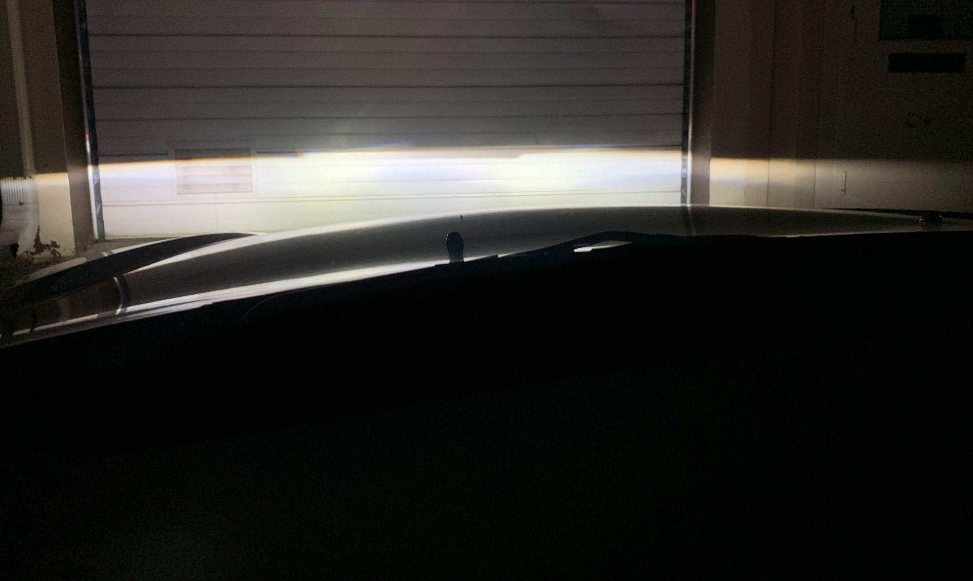

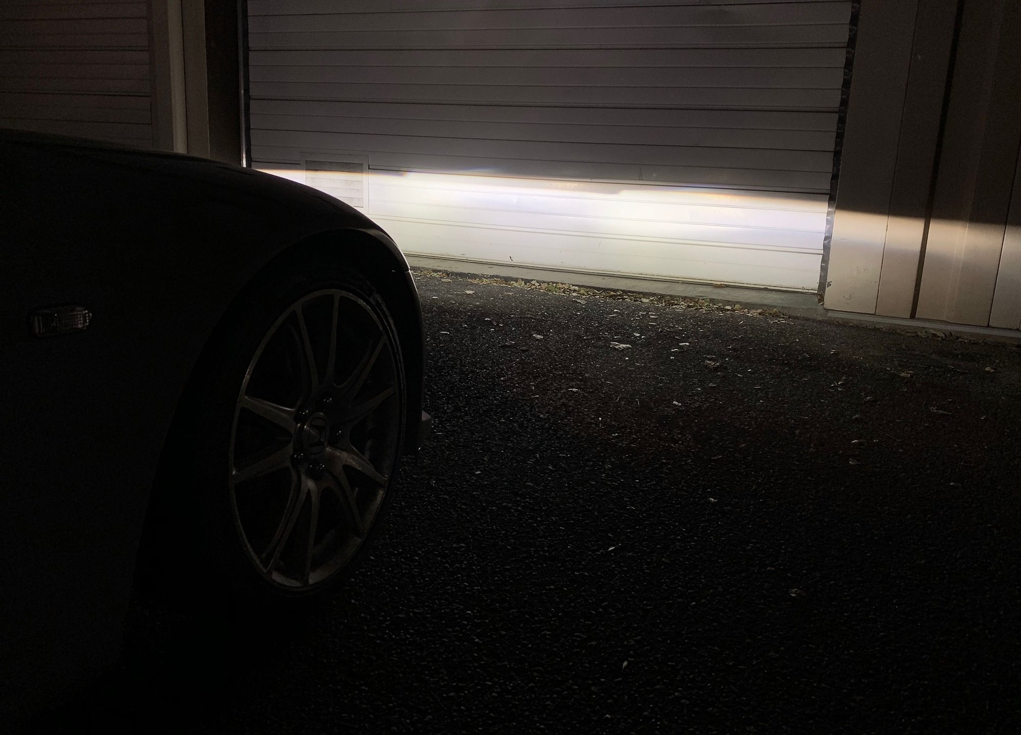

Here's a couple quick pics from earlier tonight. Yes I know my headlights need to be aimed, I just haven't taken the time. iPhone pics don't show the true white color of these bulbs either. They are the 50 watt Saber Pro LED bulbs from DDM Tuning. I'm happy with them. Just wish I would have taken pics like this before removing the OEM HIDs for comparison.
Old Oct 19, 2018 | 10:18 PM
  #29
Kyle's Avatar
Joined: Jun 2018
Posts: 2,116
Likes: 671
From: Connecticut :(
Cutoff doesn't look too bad. I'd be curious to know the actual light output in a numerical value in comparison to a properly functioning HID system. I don't remember if you mentioned it in this thread or not yet but may I ask why you made the switch? I can understand to a degree if you needed to replace one or both ballasts or something of the like and this was more cost effective. In terms of color output a simple bulb switch would've sufficed. Not really attacking your decision to do what you did, just curious why. Proper projector HID systems still trump LED in terms of range and output, but obviously dedicated LED headlight technology is quickly catching up. Until they can come up with a 360* emitter LED "bulbs" will always suffer from hot-spotting and glare in reflector-based systems, it's just how the game goes. In terms of LED bulb design I think the best one I've seen is the Nokya LED bulb. It uses one big forward facing chip pointing at a metalized cone that bounces the light back towards the reflector; I'm no engineer or mathematician but typically you want an even dispersion of light over the entire area of the reflector; this achieves that.
