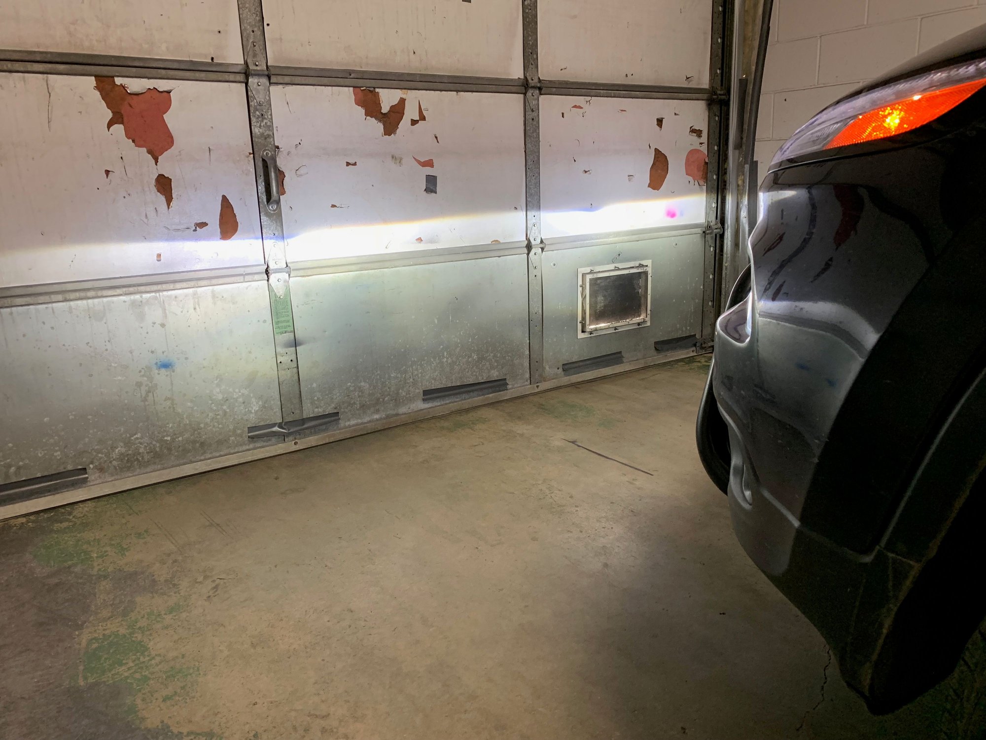

Here are some more pics I took yesterday for comparison's sake (should have turned the lights off in the shop, oops). A customer brought me his Jeep (already had another shop install LEDs in the stock projector housings), to upgrade his lights to something he can actually use to see. These pics are exactly why most typical LED headlight bulbs are getting a bad name. I don't know what brand he had in there, but you can see the light output is terrible, not aimed correctly, and the closeups of the bulbs show how small the LED chips are. The DDM Saber Pro 50 watt bulbs have much larger LED chips.
Hopefully these LED bulb manufacturers will at least make a 4 sided bulb so there are LEDs on 4 sides instead of just 2.
Before:
After:

Originally Posted by treimche
The cutoff line is controlled by the projector housing, not the bulb.
Doesn't look that way to me in the pics you just posted comparing two different "LEDs on a stick", lol. You do you though.
