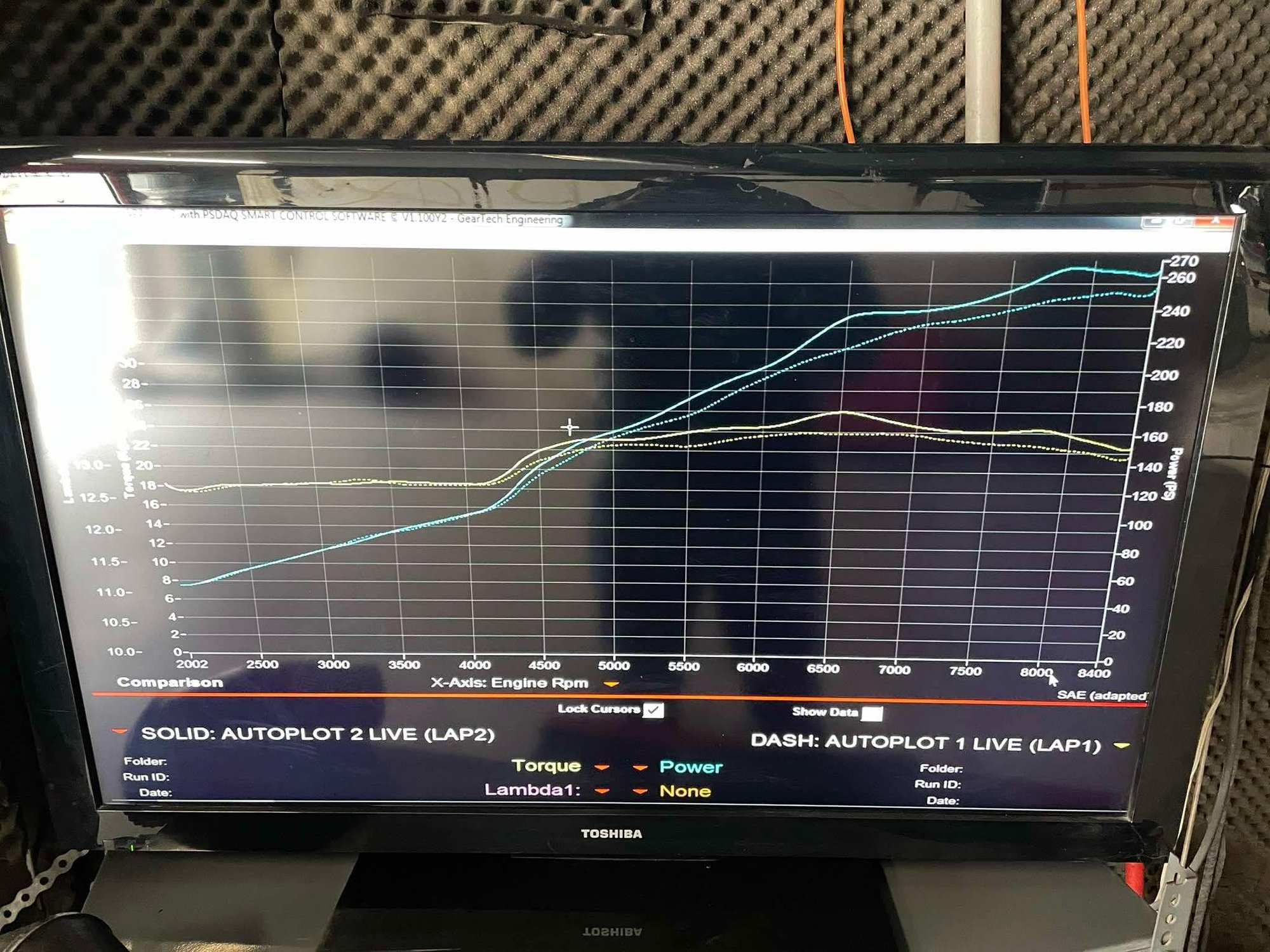

sone update
swap toda b2 camshafts with BC stage 2

wanted to try something else .
the car have lost some power in low and mid revs but in high revs its the same

dyno with air box and without .more power without airbox

29kgm = 210 ft/lbs thats amazing!
More torque in this car than peak power for most NA S2ks!
that’s incredible!
