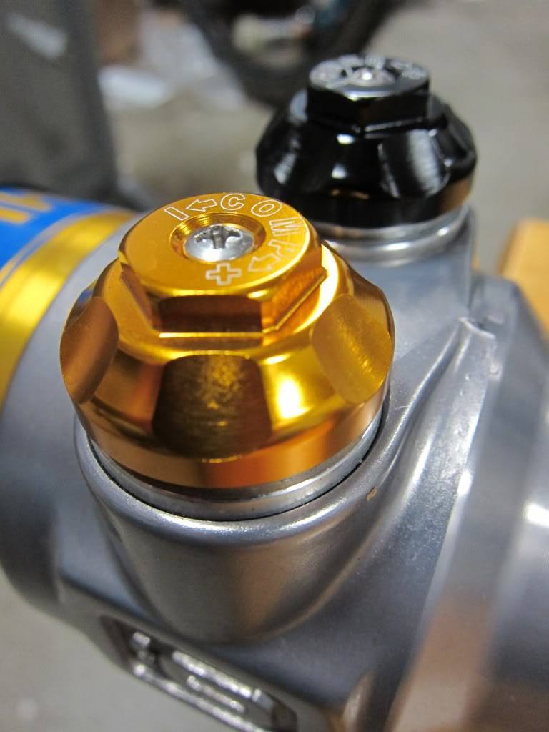

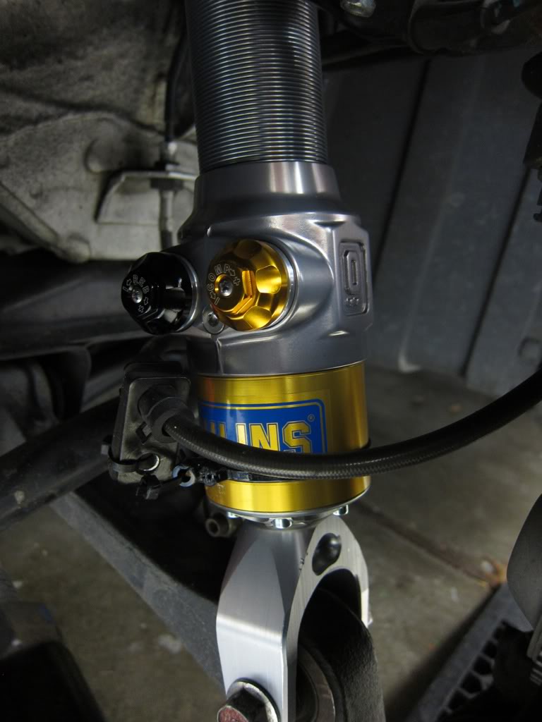

Some installed pics
AST Top Hats
Comp and Reb in one place is nice
Clevis

Any trouble with sway bar clarance in the front? My Gendron front bar is vary close to my Koni's and these look bigger.
Old Mar 15, 2011 | 06:12 PM
  #125
macr88's Avatar
Joined: May 2006
Posts: 14,847
Likes: 10
From: Emmett
I'm only running the CR bar with stock end links and it clears by maybe a 1/4" or so. Not really sure about the Gendron bar though If you have any ideas of how to measure for it let me know.
The reservoir diameter is 64.3mm and I have roughly 7-8mm of clearance to the stock end links on a stock bar from the reservoir.
