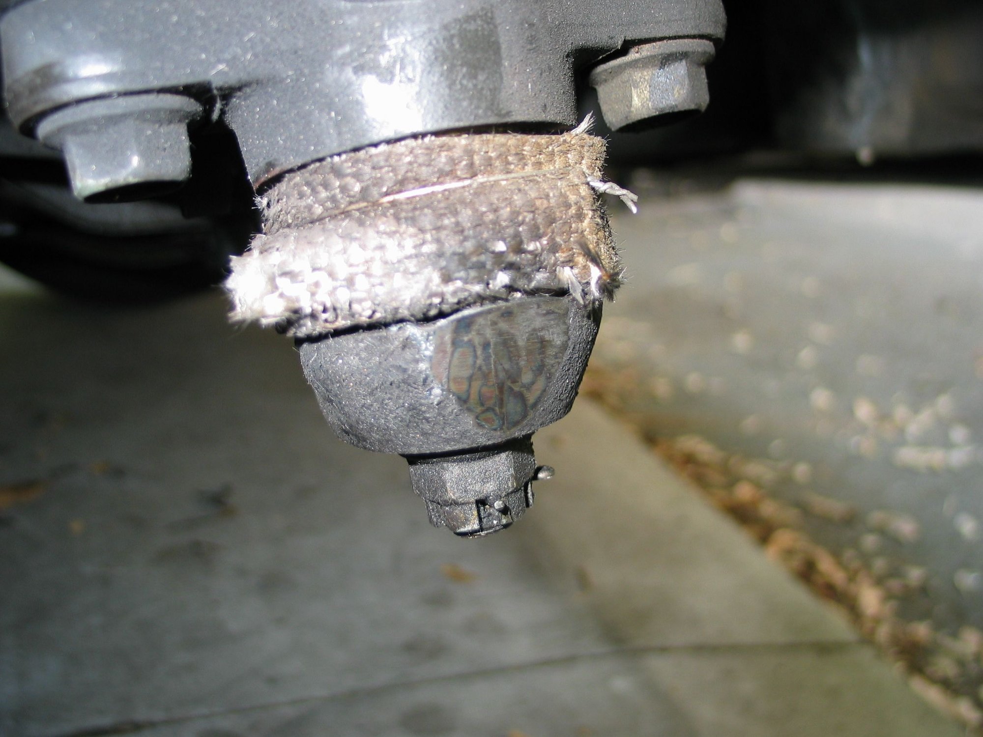

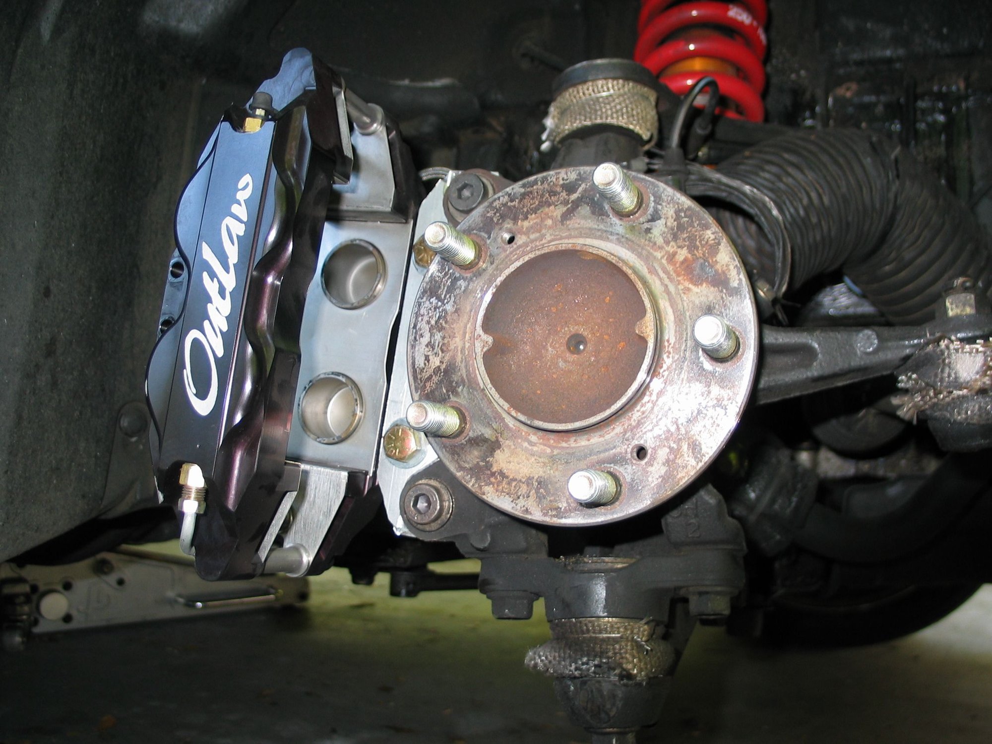

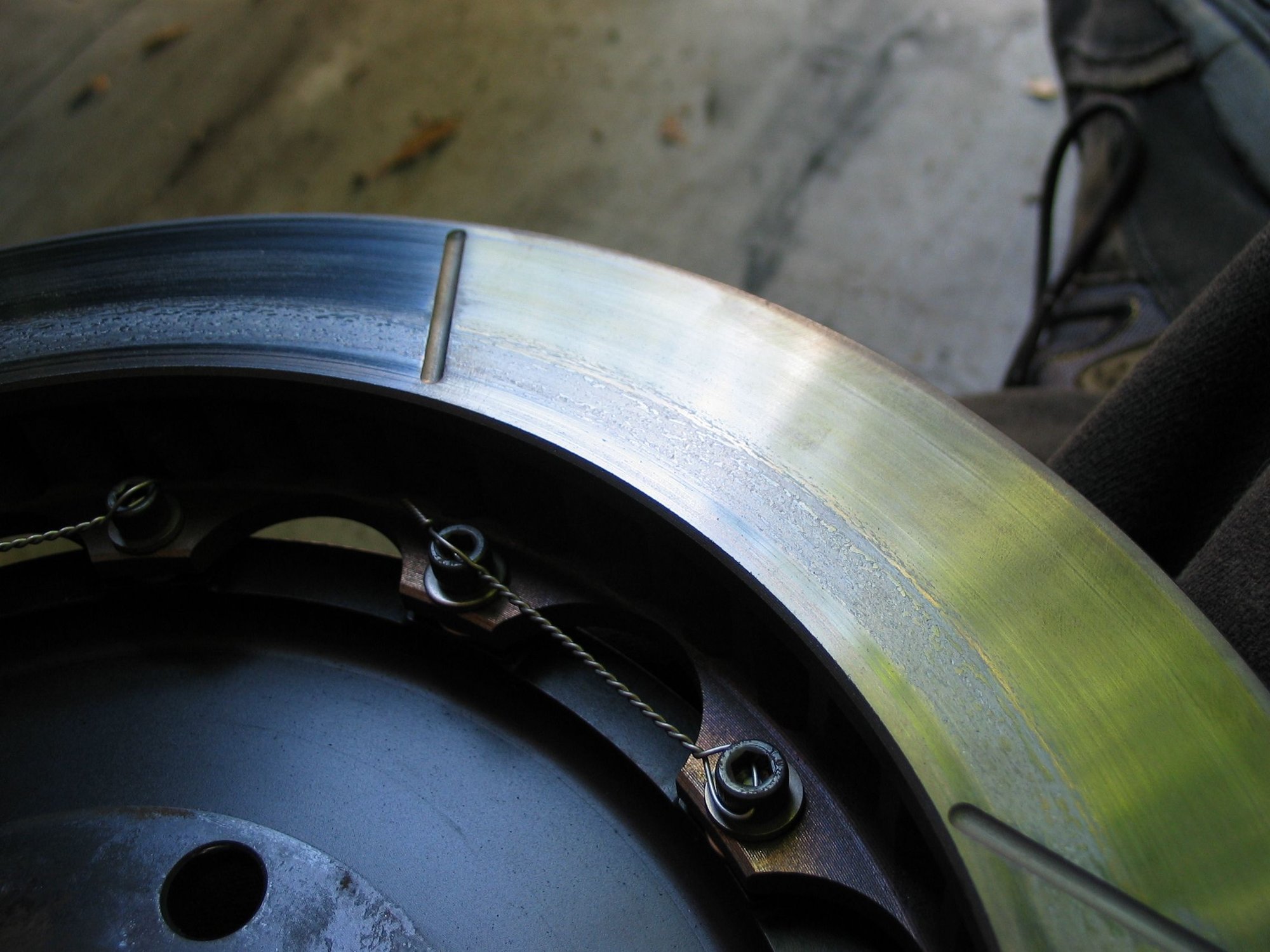

Sorry for the long delay in updates. Its been slow going the last couple months.
Well I got the fronts complete and in working order and got a chance to try them out at the new fernly/Reno track.
They seemed to work quite well. Very good pedal feel and absolutely no fade. But then that was to be expected as the fernly track is very easy on the brakes. Only one really hard braking zone in the current configuration. When I got the car back home I tore the front brakes down for inspection. Turns out the the lower ball joint protudes further out than I thought when the suspension is compressed. Doh! This resulted the casting rubbing up againt the rotor until the cast was shaved enough to no longer rub. I have since taken a die grinder to the casting to generate a little more clearance. See the pics below. If this continues to be an issue I'll have to increase clearance by redesing the brackets etc. I might also have to install longer lug nuts as well. For now I'll continue to test it as is.
