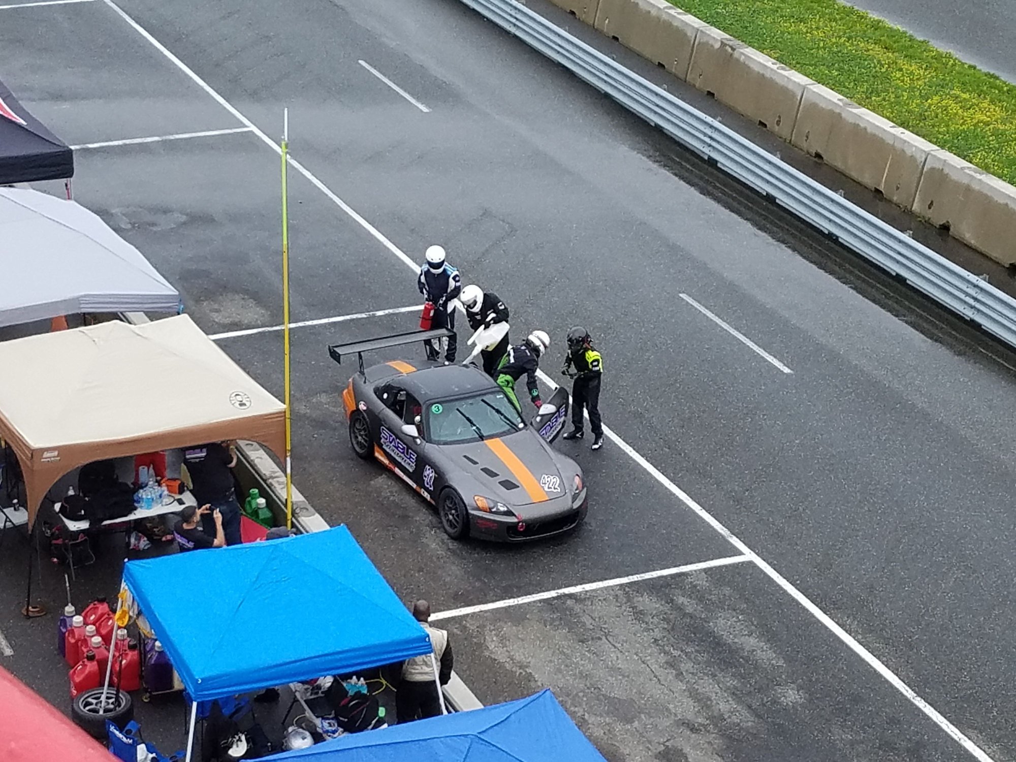

I did an AER race this year in my s. Day 1 was full rain, and day 2 we lost clutch in first session due to throwout bearing failing. So unfortunately I don’t have great data.
That said i spoke extensively with Paddy and Pete, plus others who’ve done endurance racing over the years in the S. Turns out there’s actually a lot more s’s that have done them then you’d imagine. Mostly the limited SCCA endurance events such as devil in the dark.
The outside temperatures make this biggest difference in what cooking you do or don’t need. For the extreme, you need to go fill out from trans/diff cooling, and all. Worst case need to change those fluids out before and after day one if a two day race.
Fuel, with stock tank I’d budget and 75mins max, however, some hyrdomat, will buy another 5-10mins, possibly lowering redline/early shifting will help, etc. I think though if you’re serious about endurance racing a cell is the way to go.

Throwout bearing? How did it manifest itself? Sounds like a Richard III moment: "My kingdom, my kingdom for a horse."
With just over an hour between refuelings, was refueling time an issue? It looks like a nicely prepared car, was a dry-break, quick-fill setup configured? Was a driver change planned for each refueling stop? Were brakes expected to run the entire event or was a pad change planned? Were tires expected to last the entire event? If not, how often were they expected to be changed?
What determines the need to change the transmission or diff oil after a short running time? Which oil was used?

The AER rules seem to allow a dry break...and any size fuel cell. The dry break manufacturers claim very fast refueling (less than 10 seconds for 11 gallons.)
