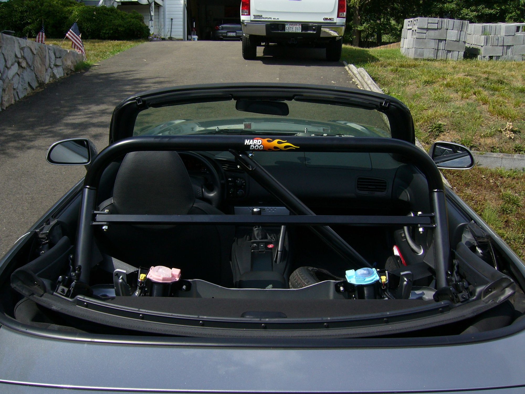

Here are some pics:
This bar is currently out of my car and for sale. If you're interested, PM me. This one was an early bar that interfered with the seat belt guide that bolts to the stock roll hoop, but if you are ok with removing the roll hoops entirely, it will have zero problems. I've picked up a second s2000 for track use, so I'll be having a custom bar welded in over the winter.

^^^ Where is the harness bar?
It's the square tube that runs directly above the secret compartment lid.

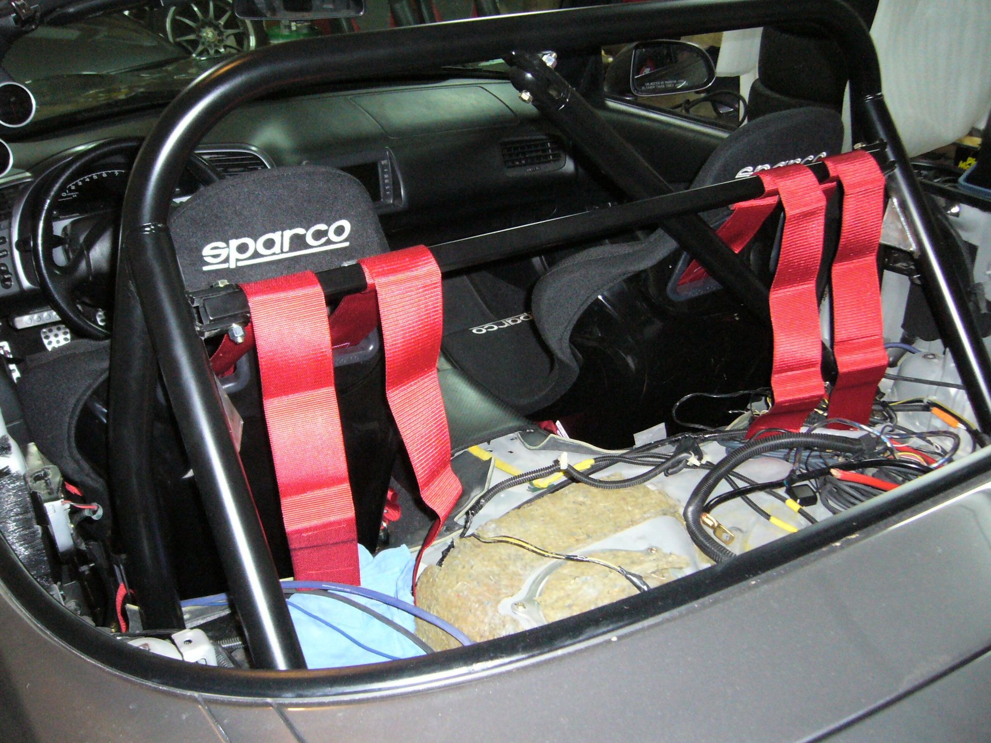

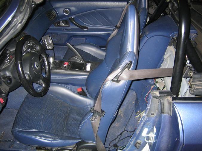

For the record, I've had the Safety21, the GFL/HD bar with seatbelt retractor mounting tabs added, and now a fully welded HD bar(center console/softtop removed). This doesn't make me a guru, but I do have experience with each one of those bars.
Welded HD bar in my car
GFL/HD design before interior went back into 4W MCYL's car
GFL/HD bar in my car

Skip's right. When designing a bolt in bar for the casual track user, especially in a car as tight as the S2K, certain compromises have to be made. The hardcore users have all had custom solutions welded in which required removing the interior partially or even completely. When you're willing to gut the car, you have a lot more options but you're not the target market for a bolt in solution that allows the retention of all the amenities.
