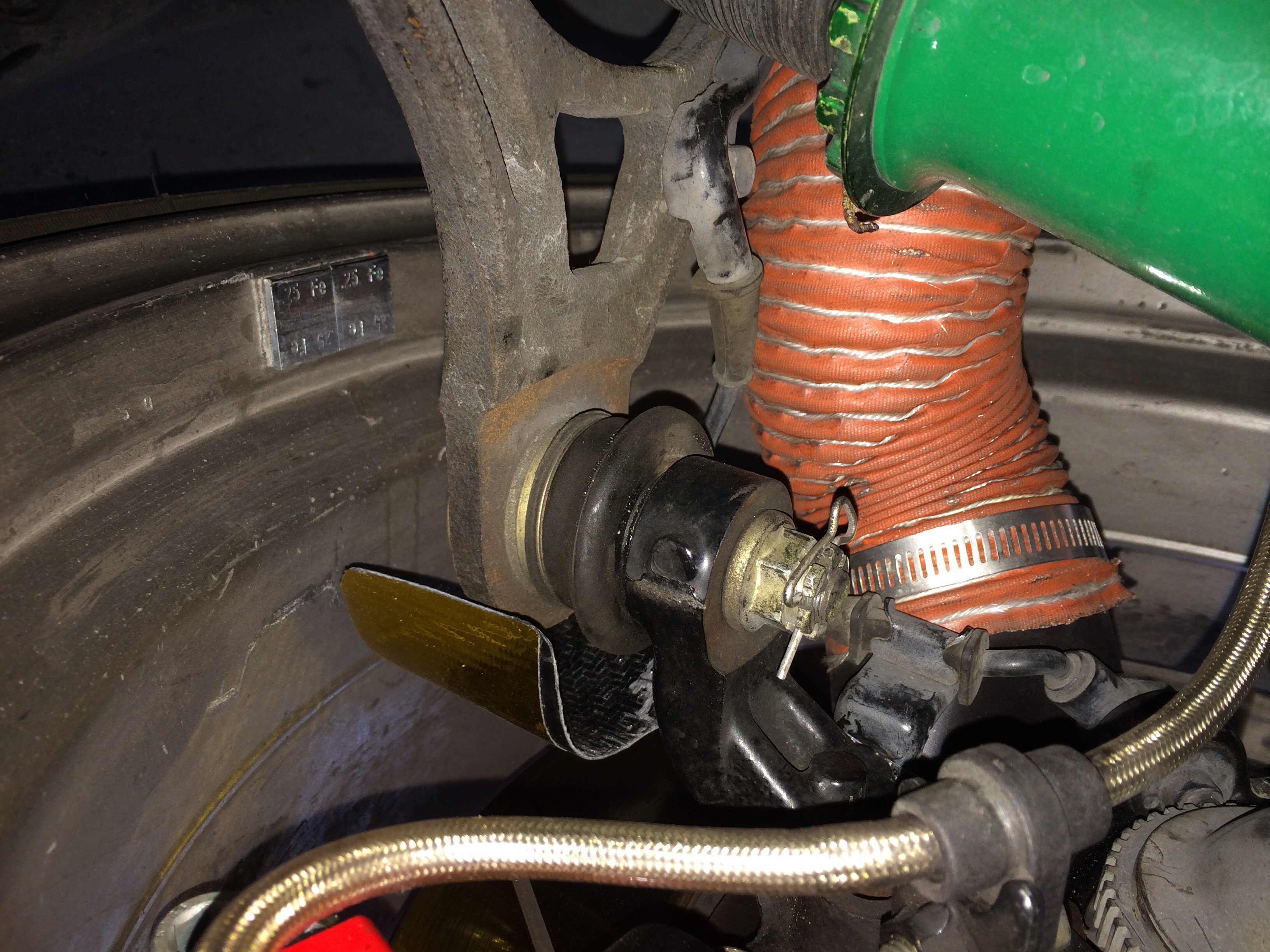

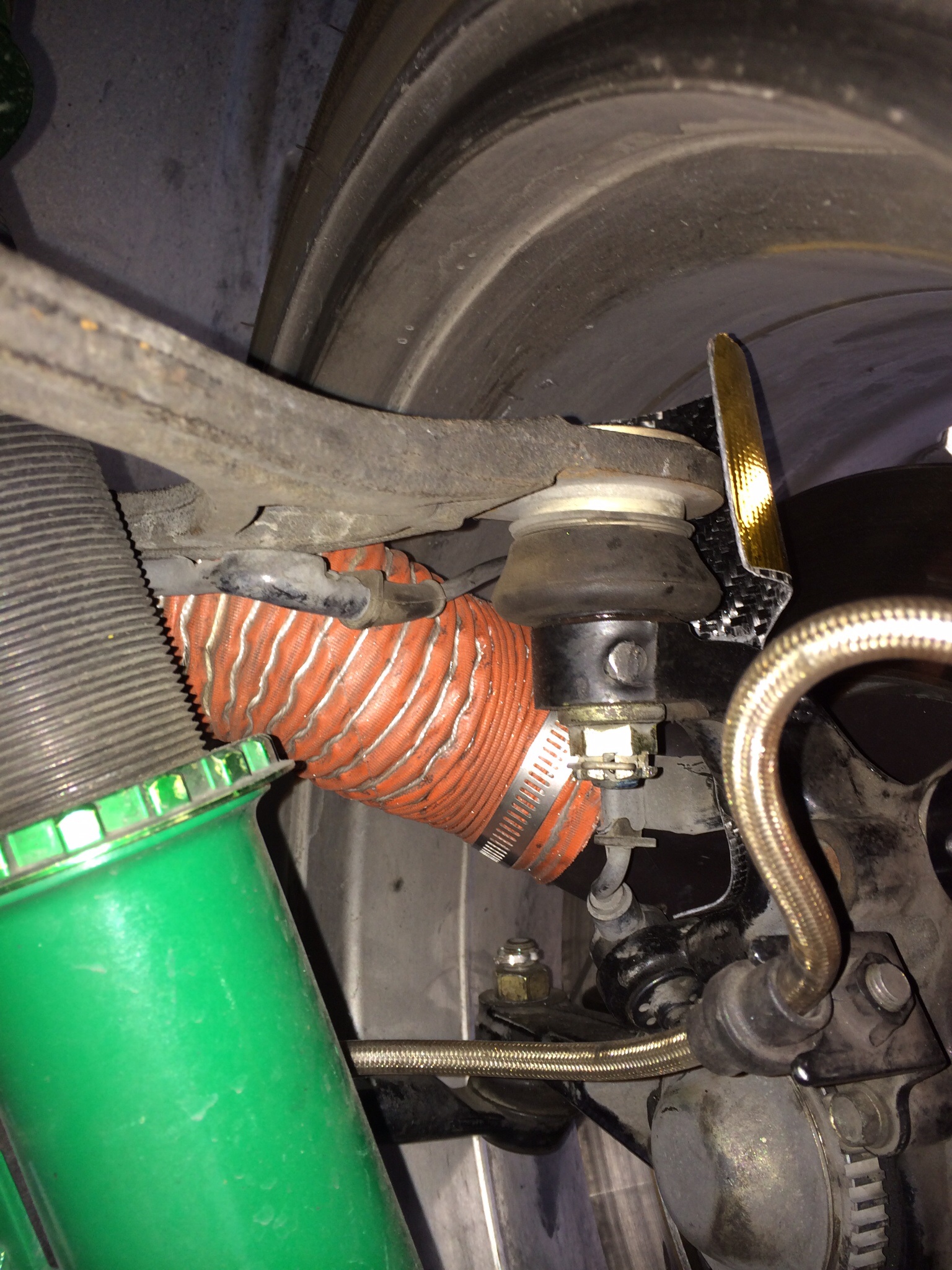

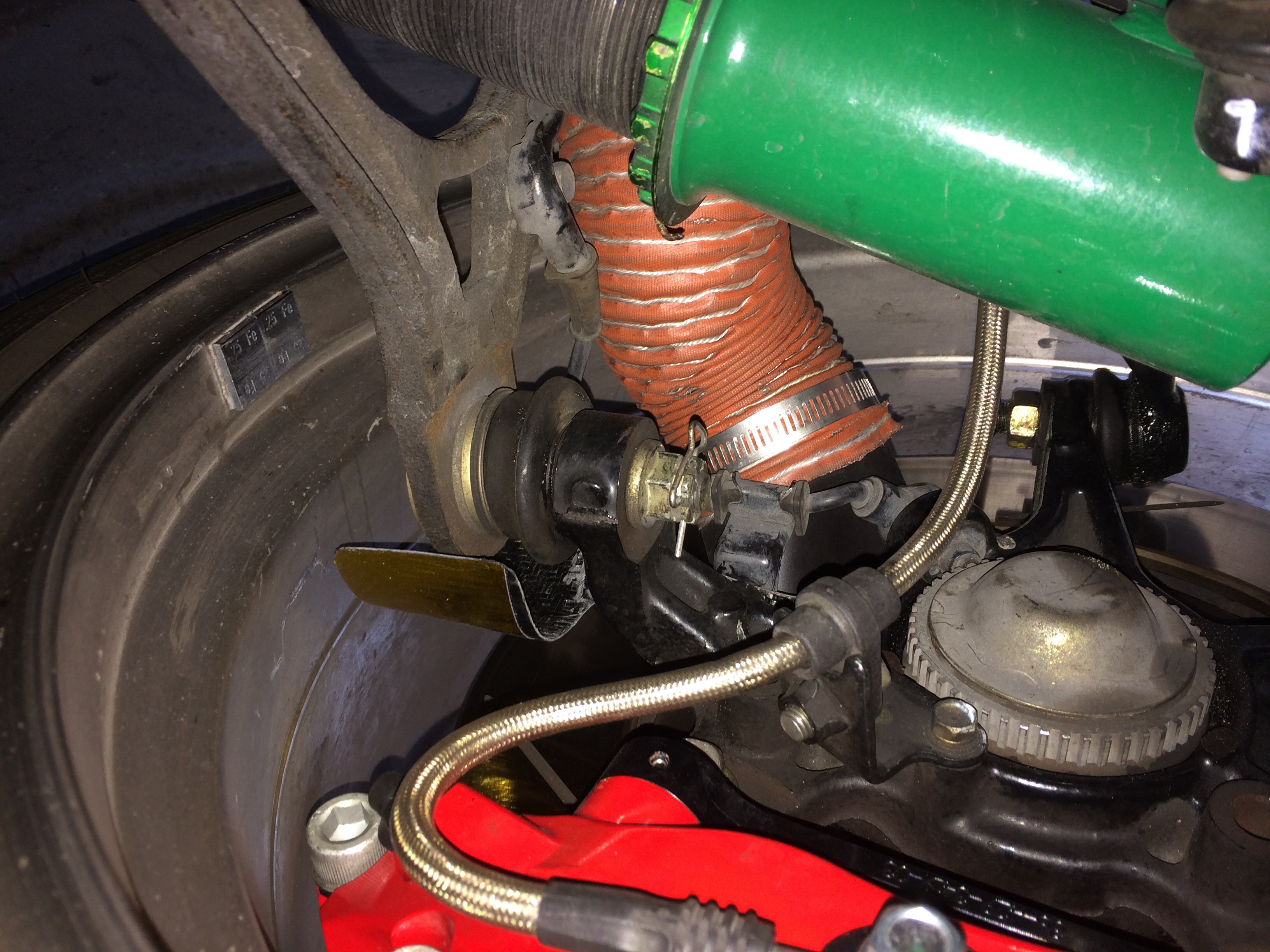

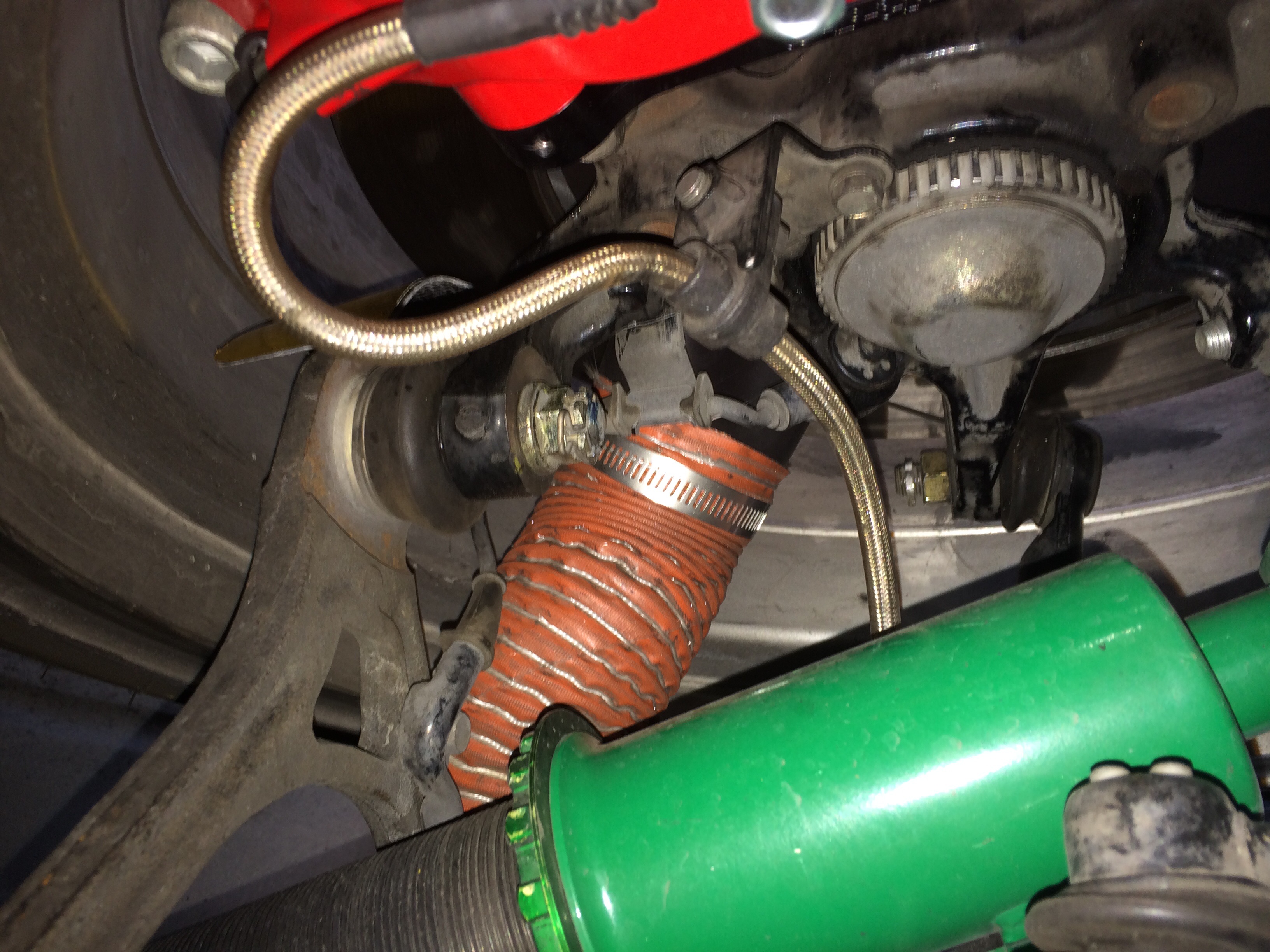

It looks like everything is ok under the car
Here are some pictures but I can't see anything bent unless i am looking at the wrong spot
Thanks for all the help guys

But I also guess if I buy some subframe spacers I don't have to worry about if my sub frame moves. Then I can really check if something is bent
