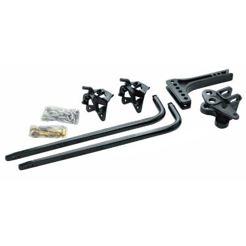

Glad to hear the trip went well. We talked about this in another trailer thread but if you're going to be towing your S o a regular basis you should consider a weight distributing hitch. They are as cheap as $180 on Amazon. It will help with the handling and make the tow safer.

I went with a Equalizer hitch. It does weight distributing and sway control. It's awesome to tow, I have never gotten sway ever - the trailer stays rock stable behind me.
The bad part is that it takes a little longer to hitch up (a few minutes), and it's noisy/slightly embarrasing at low speeds when you turn (there's metal to metal friction by design). Some people that have never had a hitch like that look at you weird, hah.
Overall it's worth it though. I might have considered a different design like the Reese that isn't as noisy but I don't know if that has its own problems.

OP, I'd try this before changing shocks or doing airbags. This will equalize/level the load and truck, and prevent that swaying
Lift kits and airbags do not "increase the payload" of the truck. They will help level the truck, but the payload will remain the same.

The basic hitch in the picture above is $180 at Amazon and it has 2 mounting locations to add 1 or 2 sway controls to it for about $56 each. But I'd suggest you try just the hitch first which will help with the sway and then if you still need the sway control you can add it later.
I definitely agree with Blue's suggestion to do a hitch instead of airbags.
