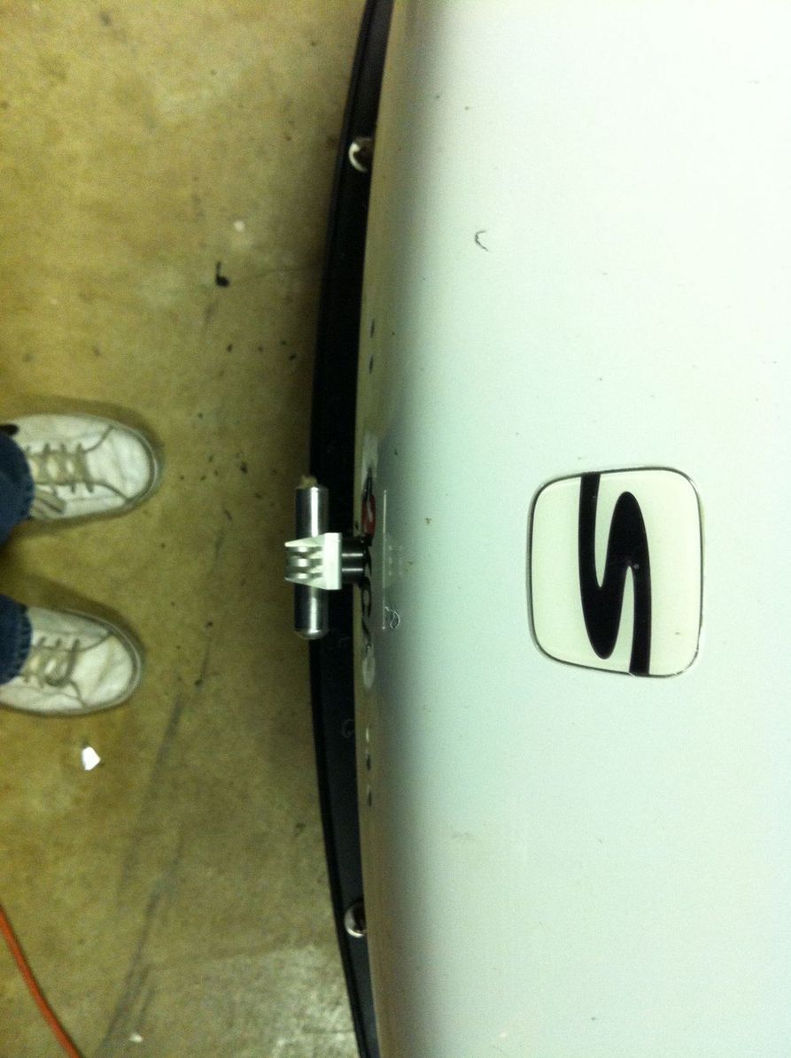

Strat, how did you anchor a central mount front bumper tow hook?
Old Apr 11, 2013 | 07:48 AM
  #52
Stratocaster's Avatar
Posts: 11,399
Likes: 19
I had a 5/8 - 11 nut welded on the front of the crash beam dead center. There is a support inside that bean that was notched and welded into place as well.
Note: There is a Gopro mount onto of the tow hook
