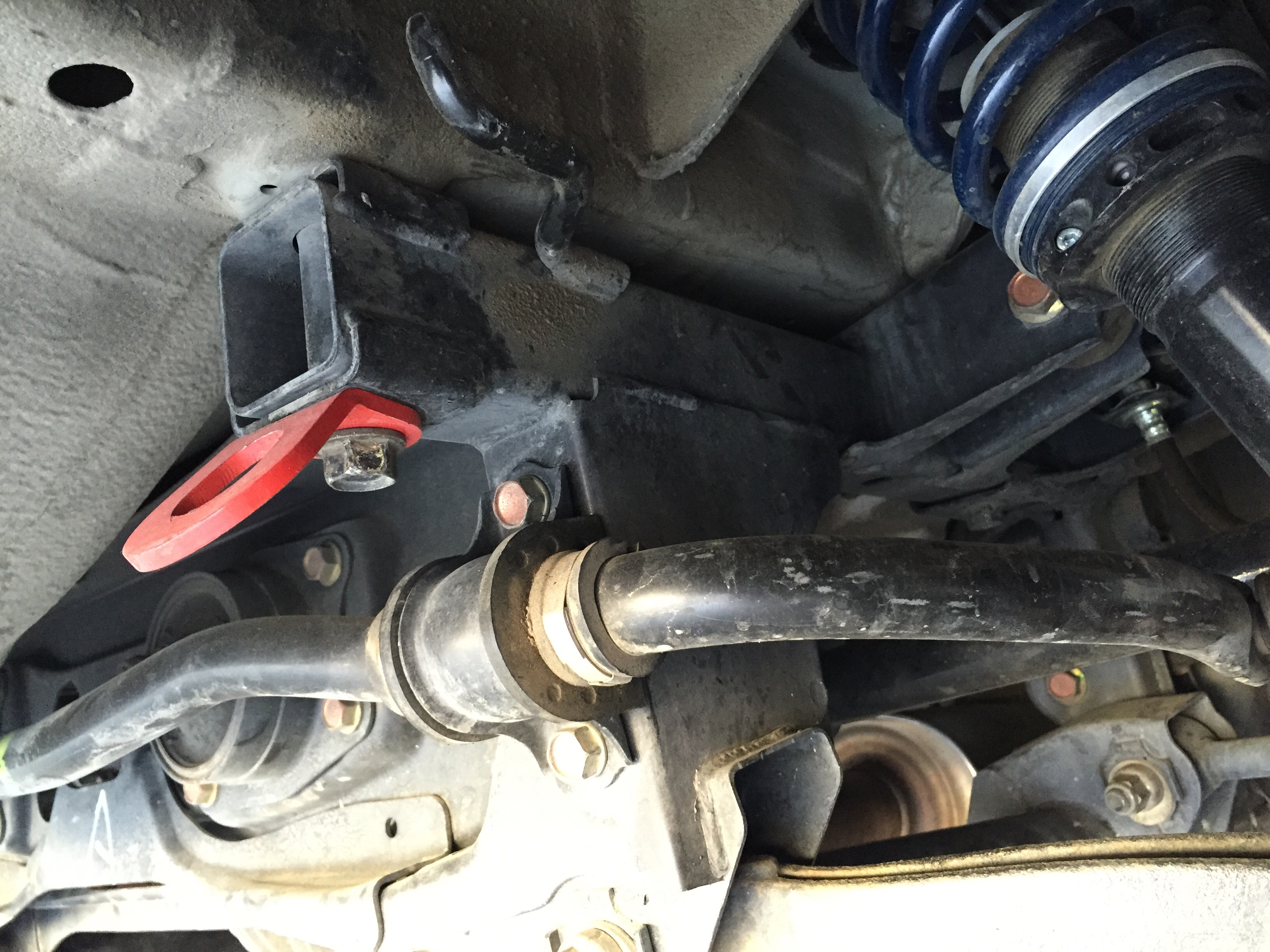

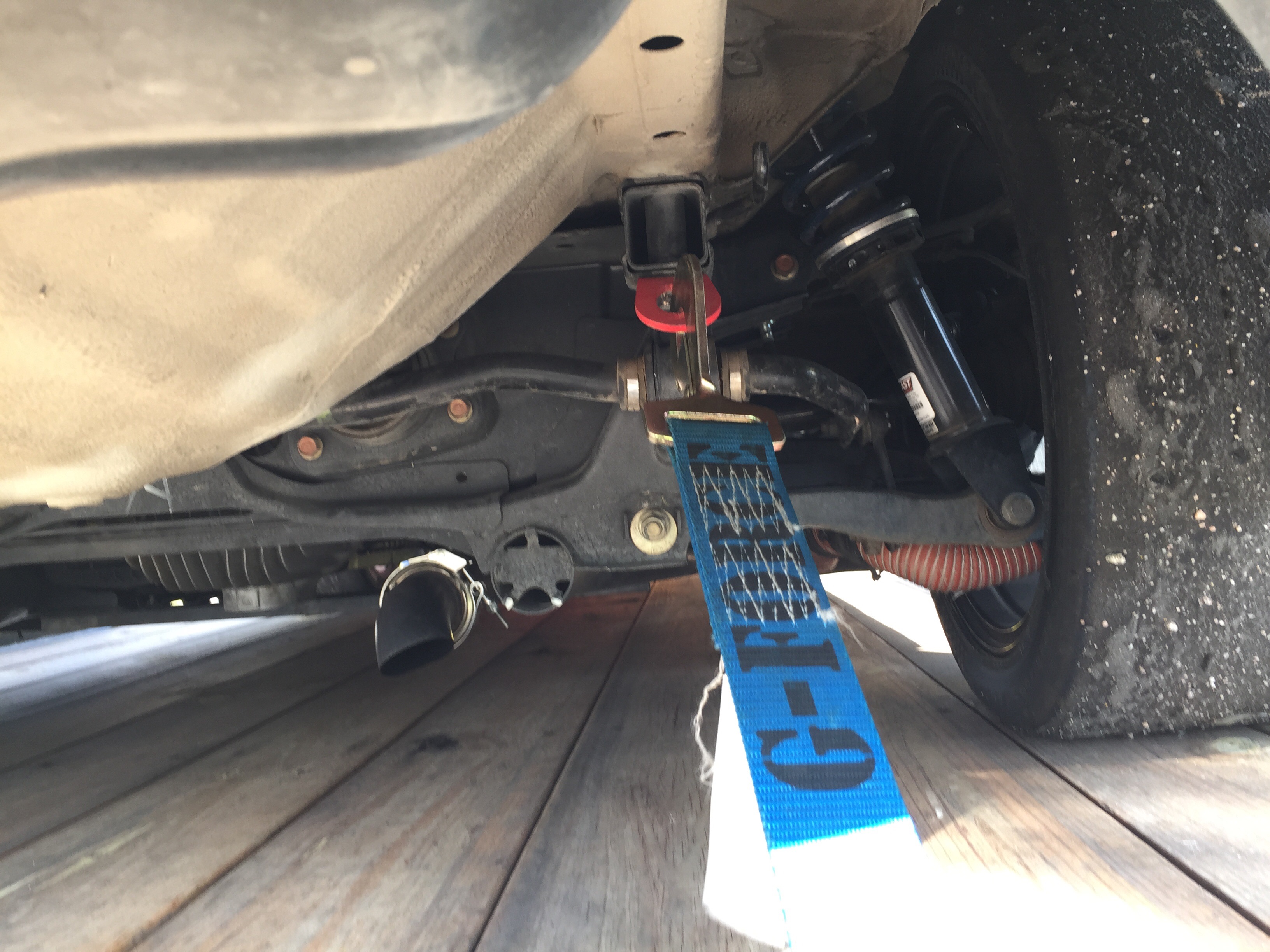

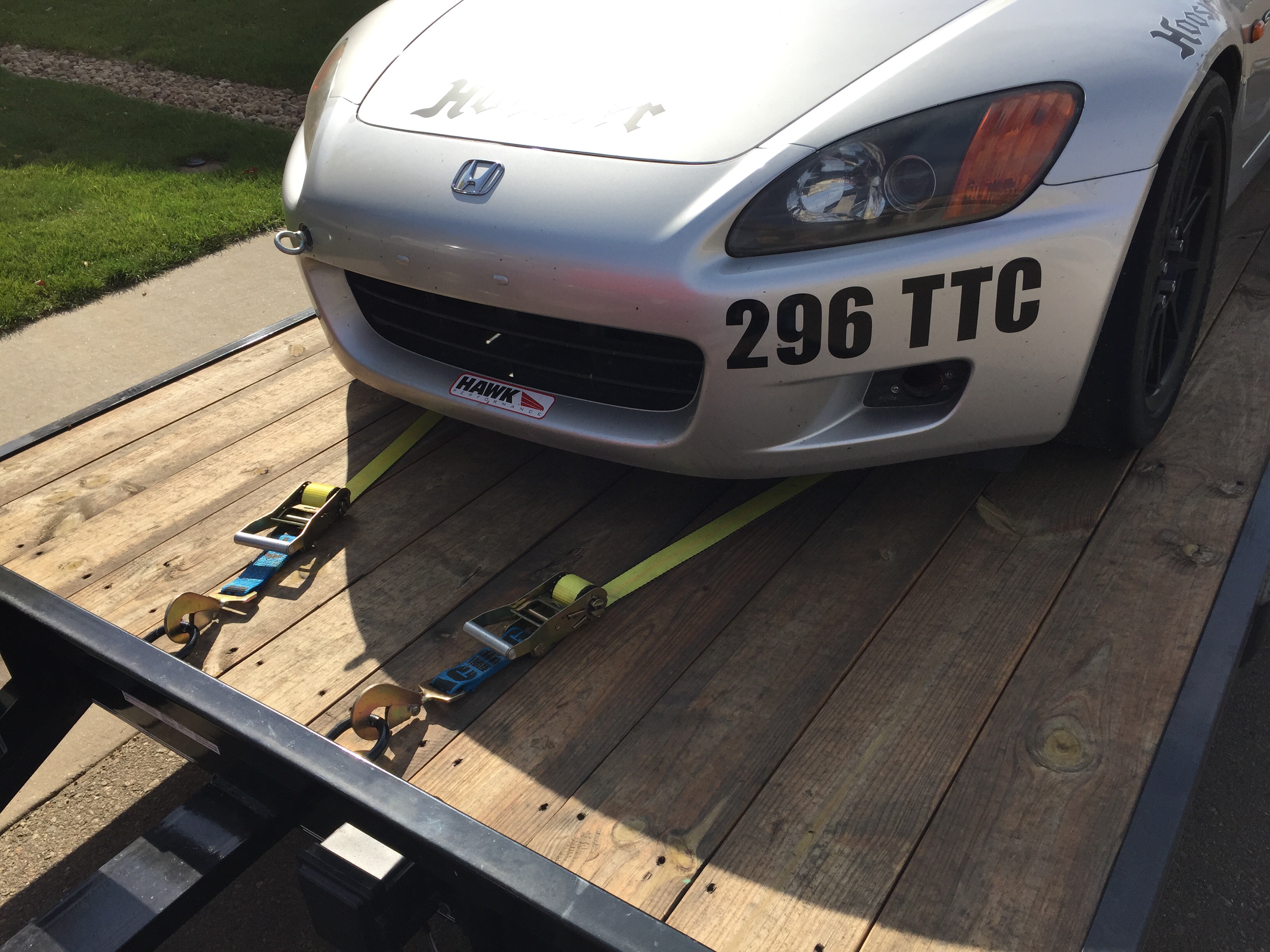

Better late than never:
Attached Thumbnails How to strap down the s2000 on a flat bed-image1.jpg   How to strap down the s2000 on a flat bed-image.jpg   How to strap down the s2000 on a flat bed-image.jpg
can you provide another another angle of your second pic? I like to see how it is mounted.

  #68
ndogg's Avatar
Joined: Apr 2012
Posts: 450
Likes: 13
Here is another angle for ya.
Did you use the oem bolt or an extended bolt?
I just used the oem bolt.
