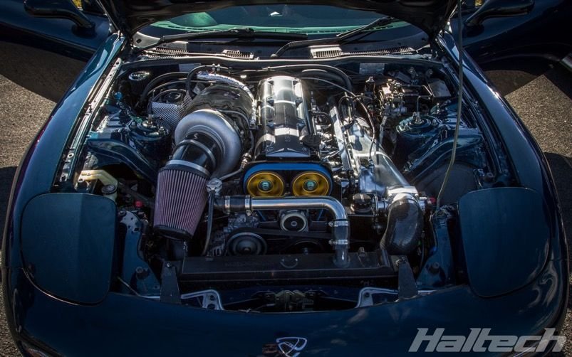

Tripped across this 5 minutes ago: a 2JZ-GTE powered FD RX-7. The write-up says 1400hp. https://www.haltech.com/tag/2jz/
The 2JZ isn't that much heavier than a K24, maybe just over 100lb. About the same as an LS/LT. Its claim to fame is the ability to take boost. So much boost that people don't develop the rest of the motor. It probably isn't a good track day engine. However, drag racing--1/8 mile, 1/4 mile, 1/2 mile--it may be your lowest cost path to 1500hp.

Why are you still going on and on about the 2JZ? It's a terrible choice for any form of racing outside of drag or drifting (where front-biased weight distribution doesn't matter so much). It's heavy and very long. Look how far it sticks out past the strut towers. It's no longer a front-mid engine car with a 2JZ. You're making the weight distribution & polar moment of inertia significantly worse. That changes handling quite a bit.

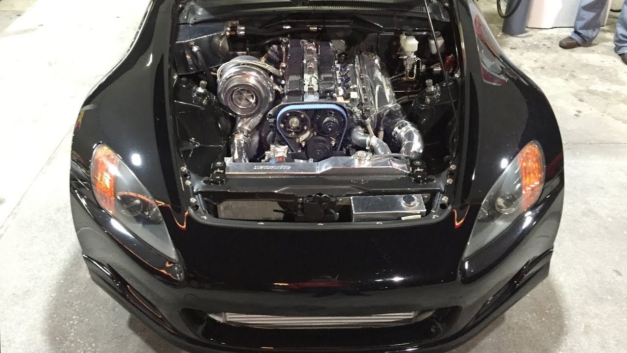

The 2JZ remains interesting because the JDM VVTi versions are under $3k. Lots of parts are available and for a relatively low cost it can be a 1000hp engine, assuming the right fuel. One popular conversion is to stick it in an S2000. It doesn't even look that far forward in the chassis on an S2000.
