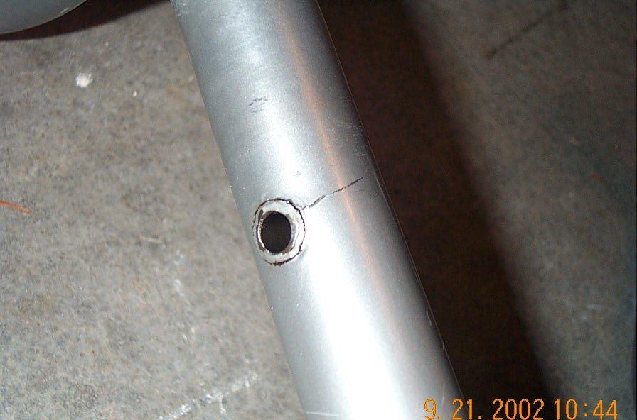

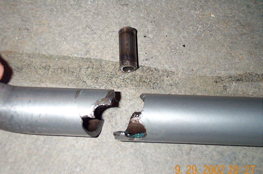

Mack's Avatar
Posts: 1,182
From: Knoxville
Had a local event today and the bar finally failed completely. Took a few shots for posterity's sake.
Here's a shot of the crack that that I noticed a few weeks ago..........
Two events later and this is the result............
FWIW When it fails you will know it. Race tires and no front swaybar is a hand full! This bar had about 25 events on it. Some on concrete some asphalt. I'll be contacting Comptech tomorrow to inquire about what they have come up with in the way of a fix.
