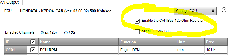

For anyone else pulling their hair out in 2024 trying to get this to work, you must check "Enable the CAN Bus 120 Ohm Resistor" option!
