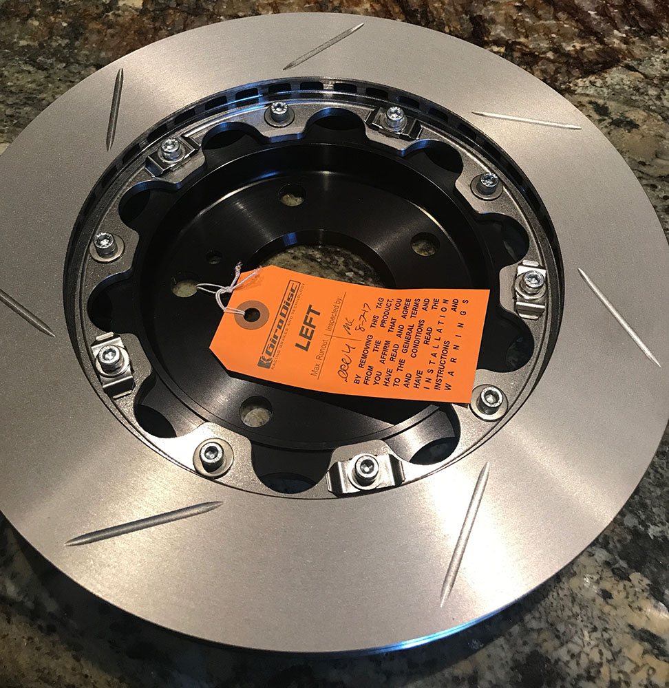

First event in the books and so far so good! The track I was at wasn't a high brake demand track, it only had 1 major braking zone that took you from ~105 to ~55, however laps were short (1min 20sec). Overall I will say that braking felt very consistent throughout the weekend, the braking zone was at a point where the car was a bit unsettled and the car took all I could give and provided confidence.
As far as consumables, I haven't measured the pads yet, but just visually it seems that the front have exhibited less wear than the rear, which is opposite of what I had experience prior. To me this supports what I was thinking in that the rears were overheating and with these pads it was causing glazing and less wear in the rear, but more in the front as they had to carry more load. Note that this is just my theory based on my observation of brake feel and pad wear on OEM rear rotors. I am starting to get micro cracking on my front rotors. I am going to be removing and measuring the pads and will report back in a completely unscientific fashion
