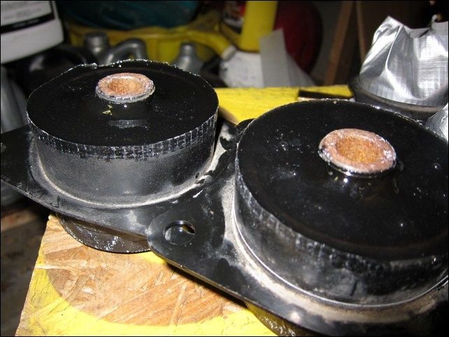

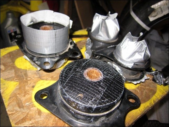

I used the shore 94 urethane from McMaster -- part 8644K18 ($33). One can was enough to do (well, over-do) all 4 diff mounts.
First, I drilled about 6 half-inch holes in each of the rear mounts and drained all the fluid. The fronts, I drilled one hole and discovered that they are not fluid-filled. I cleaned all of them with a good soak in a sink full of dish soap and water and then left them outside for a couple of days to dry out.

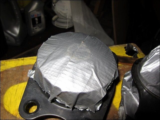

Then I taped up one side of each mount

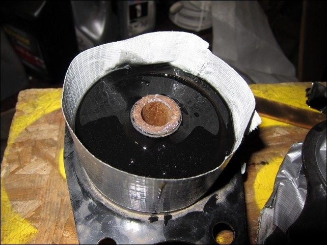

Made a 'cup' out of tape on the other side of each mount, and poured in the liquid urethane
I removed the tape after about 24 hours

Yea, I had a "man, I'm dumb" moment, and decided that simply refilling the mounts would be far more of a pain in the ass, and less rigid, and just filling the taped up mount. Pretty straightforward once you stop trying to make it difficult.
